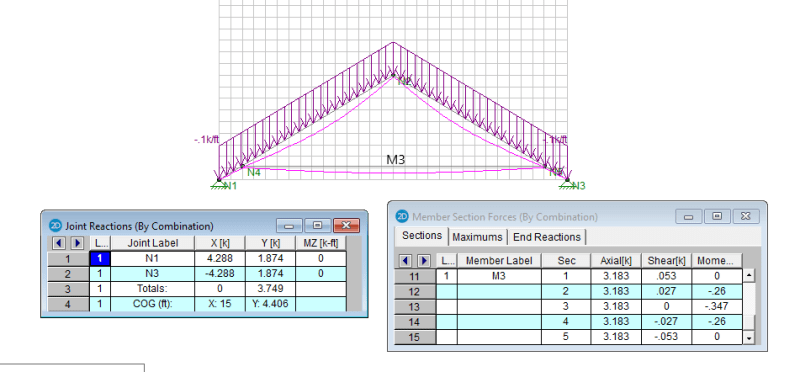

A disturbing finding, or a mistake is in making. See the simple frame analysis (by RISA) below. The scale is 3V:5H.
retired13,
You are indicating a hinge at each end, so your results cannot be right.
BA
BA,
Why? Isn't the rafter needs to be fastened to the wall, that will restrict vertical and horizontal movement of the tip of the rafter, thus acting as a pin support? I see the only case that will result in zero horizontal force is all loads are joint load, so the frame is acting as a pure axially loaded truss.
Told ya. Exactly my point. Draw it as a complete truss with the rafter tie as the bottom chord and note the tension (3000 something kips). Now in your mind, cut the rafter. That force can't just disappear. The bottom cord tension force was needed to keep the end joints from moving apart. Now, without that rafter, what will keep them from moving apart? The only thing available to resist the horizontal outward movement is the wall.
A stud wall will restrict vertical, but not horizontal movement. How could it? It would have to behave as a cantilever with zero deflection. The walls must spread by the elongation of the rafter tie plus the horizontal deflection of the rafter ends.
BA

BA,
Thanks, I got the point. After horizontal restraint is released, the horizontal reaction at the tips disappeared, with the slight increase in lateral translation. The stud walls shall be flexible enough to absorb the small movement though.

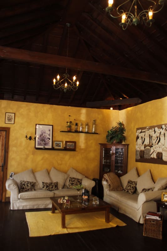

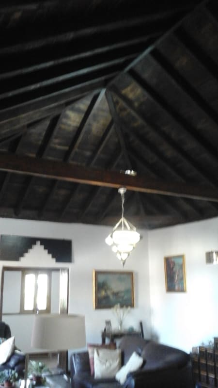

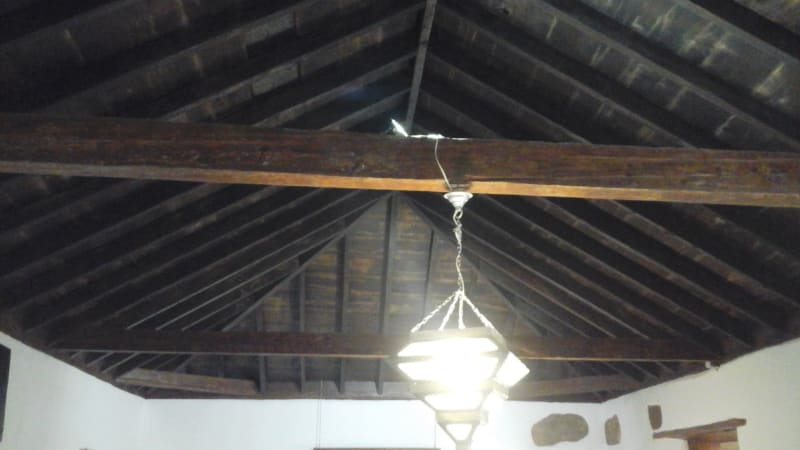

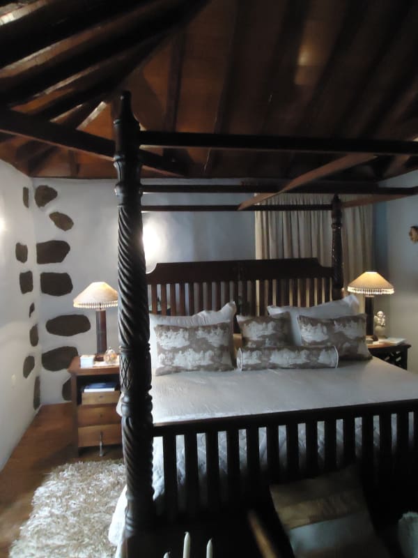

I should have thought about posting a photo of my own roof. Just took a couple. Notice the 2 long wall ties plus you can also see there also are corner ties, which I failed to mention before. All the wood is "tea", pronounced more like "tay-a". It is a type of pine and extremely dense and rot resistant. Specific gravity is nearly 1. Hard as iron and difficult to work. It quickly dulls most blades. Evven the very old, supposedly dried up stuff is full of sap that clogs saw blades in seconds. The sawdust is sticky, very messy as it sticks to my hands and shoes and the wife gets really PO if I go inside forgetting my shoes are still on. Even making a simple key chain out of it is trying. I have been meaning to attempt to measure its Young's modulus, but I have not done that yet. It is strangely fire resistant. It chars on the outside, but doesn't ever quite catch.
Some roofs in my friends houses demonstrating it is a wide spread, traditional construction technique.

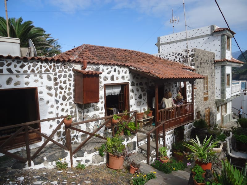

Exterior view of one of the region's typical very, very old houses.
