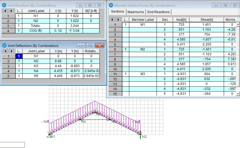

If you still need something to do, running all with the same stiffness would be interesting, maybe 2x10's ?, now that I finally got past the sign convention. That sign "unconvention", least from what I was used to, was a big surprise to me. But like I say, in the end I'm glad that was a sign convention problem and that the final result didn't contradict my intuition... at least not too much.
Thanks again for doing all that analysis work. Really nice of you.

The structure is statically determinate if supports are pin/roller. Reactions and member forces are not dependent on member stiffness. You don't need a computer to determine the tie force or the reactions. Not sure how many times I have to say this.

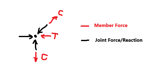

My sign convention for member force has always been that tension is '+' and compression is '-', but as stated by others, sign conventions are variable. The program really should state the convention being used to avoid confusion.

Isn't that nice when your hand calculated predictions are confirmed by the computer analysis? On the other hand, when there is deviation, albeit small, don't you interested in knowing the cause/reason (other than rounding obviously)? I don't think learning is one way street, practicing is another matter though.
One question about about the static from RISA. Shouldn't the tie be modeled as "pinned" (only tension/compression)?
Thanks,
Yes, you can use "axial force only" (truss) member, as usual is the case, for which will give you the exact solutions as hand calculation.
I hope this sign convention makes sense.

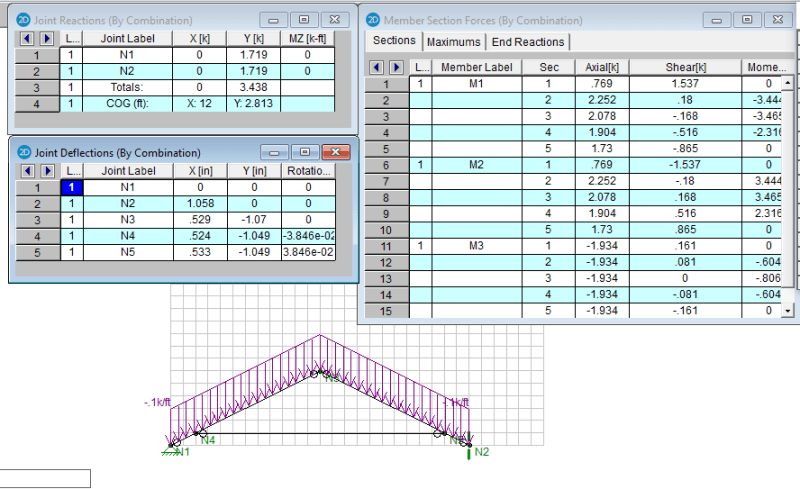

:) Wish granted. But a general shape rather than 2x10s. Note the roof slope has changed to 1V:2H (6':12') to be more realistic. There is still self weigh in the models that I don't know how to get ride of it at this moment. I'll try later.
retired13,
When specify BLC (Basic Load Combinations) remove any "gravity Y" load. That will eliminate the self weight load.
Buleeek,
Appreciate! It works :)
