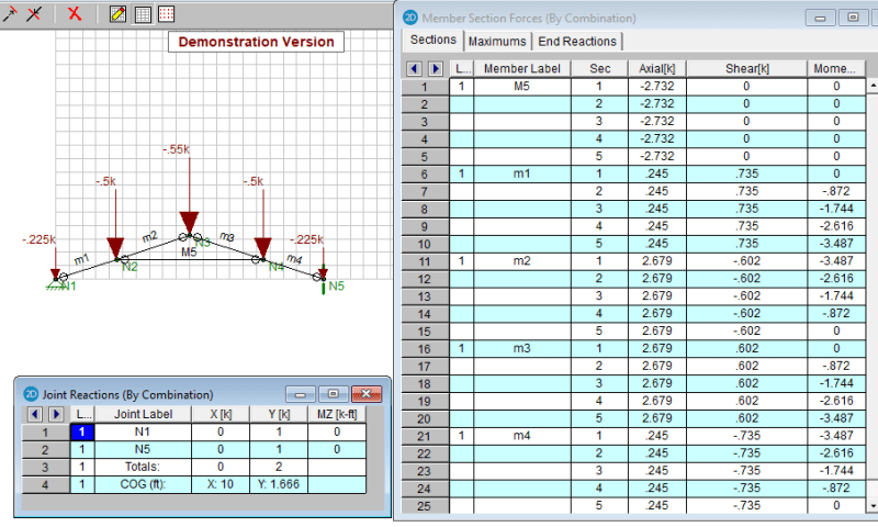

Here is my calculation assuming pin support. Let me know for mistakes. Thanks.
Sandbag A = 4.5*100/2 = 225
Sandbag B = 10*100/2 = 500
Sandbag C = 11*100/2 = 550 (275 to each side)
M = 500(4.5) + 550(20)/4 = 5000'#
When A and E are hinged (first diagram), H = 5000/3.3333= 1500 (not 2325) but this is not the case in this thread.
Second diagram, shows T (tension?) but arrow suggests compression. H value is not shown.
This is an indeterminate structure which depends on stiffness of members...can't be determined.
Third diagram - part of an indeterminate structure, so I cannot check it.
In our case, it is as I indicated in earlier posts. All joints satisfy the condition that Sum of H, V and M = 0.
M@B = 775*4.5 = 3487.5 (from forces at A)
M@B = 500*4.5*5.5/10 + 2727*1.5*1.8333/3.3333 = 3487.2 (Beam ABC moment)
M@B = 2727*1.8333 - (550/2)5.5 = 3487 (from forces at C)

H is positive as the direction shown. Due to symmetry, the calculation was performed on half frame, assuming simple truss action. The results are verified use RISA.
RISA output
retired13,
The structure you are showing above is pinned at each support. The top of a stud wall cannot resist a horizontal force of 2325#. I thought we had previously agreed that you should be using pin and roller. If you make one of your supports a horizontal roller, you will find the correct forces for the assumed geometry. I expect they will agree with my results.
The structure you are illustrating is indeterminate, which means you must assign stiffness to each member in order to find the correct solution. With pin/roller, the structure is determinate, so member stiffness does not come into play.
Just substitute a roller for one of the pins. Good luck!

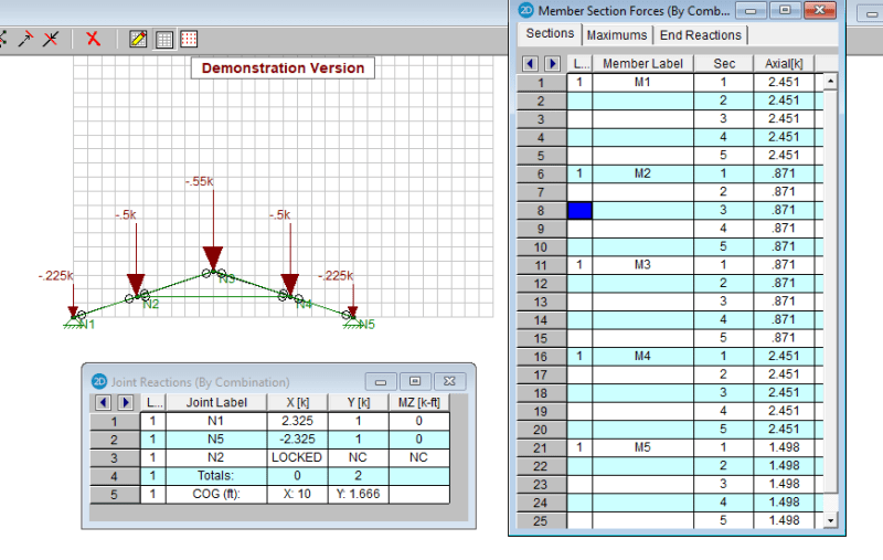

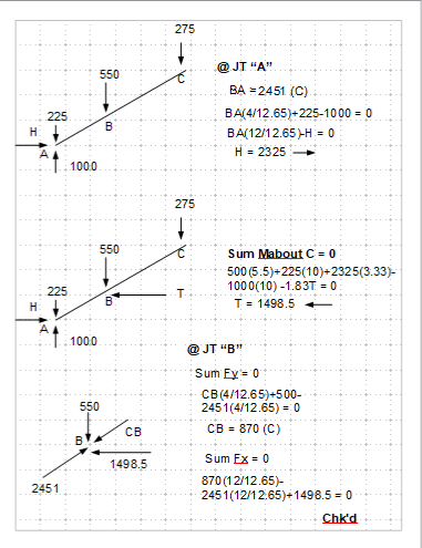

BA,
As mentioned, my last 2 analyses was performed on simple truss with axial force member only. Below is the model of your request, the rafters are single piece material with moment capacity, and one of the support is changed to roller.
retired13
17 Jun 20 00:04
That is correct, if the point load at B is 500, not the 550 you have shown, and there is a pinned support at A. Unfortunately, we were talking about a roller support at A. And, yes the arrow on the joint from BD's axial tension load should be reversed showing direction to the right. Unfortunately that change in direction unbalances the summation of
horizontal forces at B.
-870 /12.65 * 4 = -825
2451 /12.65 * 4 = +2325
1500 to right = +1500
[highlight #FCE94F]Sum Fh at B = +3000 that isn't 0

[highlight #FCE94F]Now we are getting somewhere. This is important.[/highlight]
M5 axial load is 2732. Good! Agrees closely with a sum moment at C solution.
M1 axial load is 245, not zero as a roller support might indicate in a determinate structure analysis, however the shear load in this member and moment at B must be doing the bulk of the work in resisting the 775 net load there at A without needing to generate a large axial load. Shear in M1 is 735, which is close enough for me to say that it is shear and bending moment are indeed resisting the net reaction load of 775. So not much axial force is needed to do so. So if we attempt to balance forces at B, we must not only consider axial loads, as in a truss. We must also consider the shear loads being dumped into that joint from members m1 and m2. [highlight #FCE94F]Shear loads dumping into joint C must also be considered when balancing Fh and Fv at joints of indeterminate structures we must consider Vh and Vv,[/highlight] not just the axial loads.
I have deleted the Dropbox file until such time that I can add shear loads into the joint balances.

Slope = 4/12
theta = arctan(4/12) = 18.43o
Va = 1000 - 225 = 775
M1axial = 775sin(theta) = 245#; M1shear = 775cos(theta) = 735#
ax1e said:
So if we attempt to balance forces at B, we must not only consider axial loads, as in a truss. We must also consider the shear loads being dumped into that joint from members m1 and m2. Shear loads dumping into joint C must also be considered when balancing Fh and Fv at joints of indeterminate structures we must consider Vh and Vv, not just the axial loads.
You don't need to consider axial and shear loads separately when you have the actual loads at your disposal as you do in the present case. The balance equation is easier than you think.
BA
