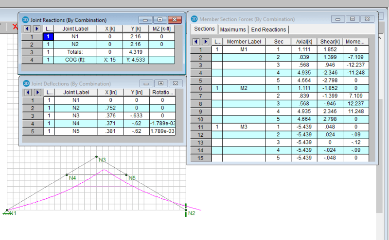

As requested. The collar ties 1s h/3 from ridge.
BA,
Very good picture with proper name for reference use.
Yup. There it is. Rafter tie tension went 70% higher and the moment in the rafter is now 12000 '# plus the deflections are vastly increased.
Nice Work. Thanks for that.
“What I told you was true ... from a certain point of view.” - Obi-Wan Kenobi, "Return of the Jedi"
Those Risa results are very confusing. What is COG? Centre of gravity? I can understand the X value of 15, the c.o.g. of the structure no matter how it is defined. But I cannot understand the Y value which was 4.406 on the first run and 4.533 on the second run. I don't even know why the COG is important (unless I am not understanding what it means).
Why have the vertical reactions changed from 1.874k to 2.16k when the span hasn't changed? If the load is 0.1 k/ft, the total load is 3.0 kips, so the vertical reaction should be 1.5 k at N1 and N2 (formerly N3).
The maximum moment at the ridge is 3.0*30/8 = 11.25 'k. So the tension in the rafter tie should be 11.25/d = 5.439 k (Risa output). That would suggest that d = 2.068', so h = 3d = 6.205'.
Counting the grid-lines on the latest output, ridge point N3 appears to be 15' right and 9' above point N1. Coordinates are not shown on the sketch, so I may be misinterpreting something.
So, what gives? It is all very amoozin' and confoosin'.
BA

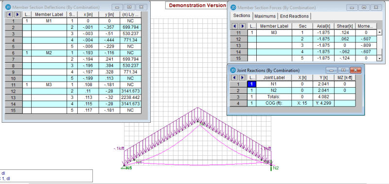

The reason is for the difference is largely due to different member properties assigned. The member stiffness of the latest model is twice of that for the first model, otherwise the deflection will slide out of page (too large), and the ridge become a curb on grade :) Same load though.
I just wat to demonstrate the effects of these two type of ties, sorry for the confusion.

The computer did not consider diaphragm action of walls or roof. It considered only the statically determinate structure depicted in the sketch by retired13. The tie force can be calculated easily by hand as M/d where M is the simple span moment WL/8 and d is the vertical distance from rafter tie to ridge. A computer is not needed. Same is true for the end reactions which are each equal to W/2.
From the RISA output, we can see that W = 4.32 kips, so the vertical reaction at N1 and N2 is 2.16 kips.
If L = 30', then M = 4.32*30/8 = 16.2k'
so d must be 16.2/5.439 = 2.98' (say 3')
Since d = h/3, h must be 8.94' (say 9')

Conventional coordinate system is use. +X is pointing right, +Y is up. Check member forces (M3, runs left to right), the second report shows the tie in tension, the first is in compression.
Sorry to be a pain, but do these not show the opposite to what you say,
First Analysis 9 Jun 20 21:40 M3 (+) 3.183K TENSION
Second Analysis 10 Jun 20 16:43 M3 (-) 5.139K COMPRESSION
Something is not right here? Maybe this is why I left structural for the petroleum industry!

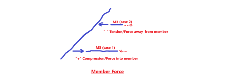

Don't confuse member forces with joint forces (note the report title "member section forces"). M3 is modelled from left to right, so "+" is compression into the member, and "-" means the force is against the direction of the x-axis, thus produce tension in the member. You are correct, if the report is for joint forces, which are reverse of the member forces.
I understand the joint forces, but I can't understand that sign convention for members. I was taught that member forces are always given in the local coordinate system with +=tension and -=compression. But that is a good thing in the sense that my "intuition" tells me that ME3 Case II simply has to be in tension, so I am more than happy to see at least that is verified.
Thanks very much. I'm returning to pipe stress (space frames) where member stresses are always +tension and -compression. (I hope)
See sketch below for direction of reported member forces (----> + local x).
Yes that is as I understand it, as those arrows represent forces APPLIED to a member. My problem is with the list of "axial forces" where their sign refers to a direction rather than as being a tension or compression force.
When I see a title that says member section forces, I don't think of forces being applied to the member. I think of internal forces. That's apparently where I am going wrong. I think of those axial forces as being a force equivalent to
F = axial_stress X cross-sectional_area, with +=ten & -=compr stresses and their equivalent forces in that member.

Yes. I admit there is a confusion on RISA's reporting method. I remember STAAD reports member force at starting node of a member section and at its ending node, so tension, or compression is very clear. But RISA chose to report the force flow in the member section from the starting node only, so the confusion. However, back to late 90s, STAAD had its own mess on reporting +/- force flow in an inclined member, too.
Anyway, I have made correction on model 1 as suggested by BA (release horizontal restraint). The result is shown below. Please note the sign change of force in/on M3. Again, sorry for stir up this confusion.
Sign convention is just that: convention. It varies from program to program. Look at Staad if you want a real horror show. It covers all bases, but covers the most common bases poorly.
Image in 9 Jun 21:40 post: Both supports are fixed in position. These supports are stopping the spreading. Nodes N4 and N5 move closer under load so positive member axial force is compression.
Also note M3 sags so it appears that self-weight is applied. Remember that Retired13 said he changed the stiffness in the second analysis so the self-weight probably changed too. That's affecting the comparison a little. It would be better for this discussion of self-weight were removed.
Retired13, why is the total vertical load in your latest analysis (4.082k) less than in 10 Jun 16:43 analysis (4.319k)? Have you changed section properties again?
How much load is due to the 0.1k/ft we can see? Is it 3.0k based on the horizontal length, or 3.5k based on the inclined length?

Good catch. Stiffer member was assigned to the second model to handle the huge deflections, that was explained in my response on10 Jun 20 18:35. This model was created in this morning with reduced stiffness in an effort to mimic the original model, but didn't get back to the original stiffness (4x12 vs 2x12). Yeah, seems I made a big mess here, but the concept is there.
I've not check into it yet, but I think RISA automatically assign/include member dead weight, if you select a member from their library. This time I selected wood material, the next time I shall try "general" type instead.
