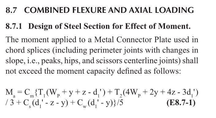

Got a job where they want a vaulted ceiling with no ridge beam. I designed 2x8 rafters with V- shaped plywood gussets. The span is only about 8.5 ft. The builder got a quote from a truss company and they are proposing what is attached.
Basically, using the nail plate to act as a moment connection at the peak. Seems a bit sketchy to me.
What do you think?

If you've already got it designed and detailed, I'd stick with what you've got. It's a good detail and I assume that you went 4' to use strips out of a common sheet. The sketch below shows an alternate option for both kinds of plate.
I guess we could even simplify your idea and just lap the suckers. Would change the dynamics of the fasteners however. My moment is only 360 ft-lbs (ASD) so it could be made to work. Might want to add some Elmers on top of that :>
I'd considered that too XR250. I was concerned that you builder might object to the plywood joints being offset across the peak. Although, it's not as though the ply is continuous across the peak anyhow.

I was think a group of nails. I have not laid this out, but If you consider a nail circle of say 4 1/2" using 9 nails and 360 ft-lb moment, you end up with a shear of 107 lbs per nail. So theoretically possible, but I would prefer a different solution that would mot be as sensitive to installation errors.

@XR: While looking as something else, low and behold, I stumbled across TPI standard provisions for plates with moment. I figured that you'd be interested, at least in passing. If you're interested in knowing more about this highly intuitive equation, lemme know.
KootK,
I would like to see the derivation of this equation. Please provide ASAP. :>
