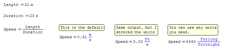

It's much more than just ease of use; units are inherently part of the math systems of SMath and Mathcad, to the extent that unit conversions are completely transparent:
since pascal is the default pressure unit, the conversion is automatic.
Additionally, because the units are integral to the calculations, they provide inherent dimensionality checking:
is messed up because I used a velocity, so result is not a simple pressure.
I defined nmi as nautical mile elsewhere, so this works:

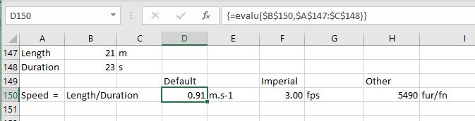

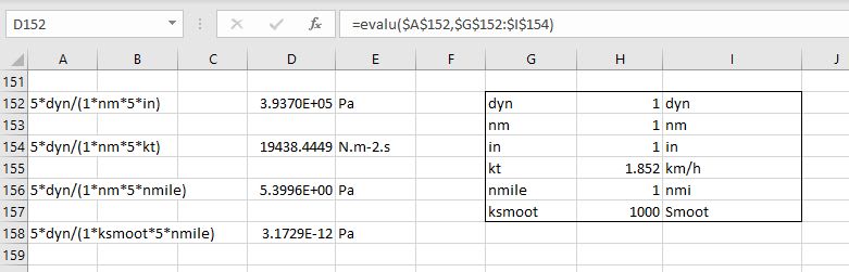

IRstuff examples in Excel, using Units4Excel:
Currently the Evalu function does not recognise units embedded in the function to be evaluated, so you have to define them as named parameters with a value of 1, and enter them as a factor, such as 5*dyn.
You can name the units whatever you want, so for instance I have named nmi (nautical miles), which is a defined unit in the spreadsheet, as nmile.
You can also redefine existing units, such as kt (knot), which I have defined as 1.852 km/h, which is the exact official definition, agreeing with the SMath result. Note that the current spreadsheet uses an approximation which is only accurate to about 5 SF. I will upload a corrected version later today.
You can also define new units, such as the ksmoot, equal to 1000 smoots.
Units4Excel can be downloaded from Units4Excel.
There is also a Python version at Units and solvers with Pint and Sympy. Note that this is a work in progress, and requires installed versions of Python and xlwings.
