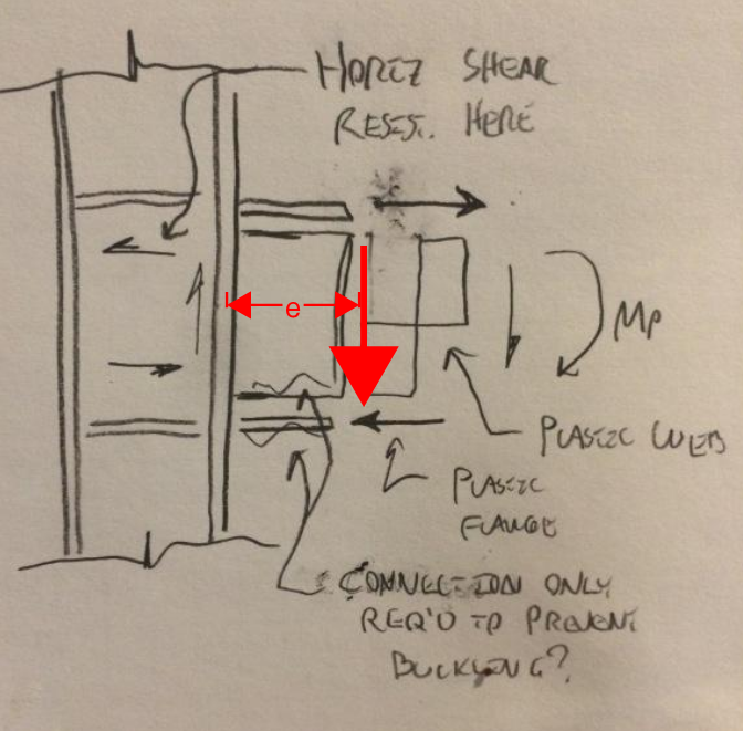

Not at all, assuming that you're addressing my proposals here. I'm talking about a system where the vertical shear resistance remains as it started: as passing through a web welded to the column flange. That ameliorates the differential vertical stiffness issues associated with bolted web connections.

Even if it's the correct story? You seem to imply that I'm being cavalier about the whole thing. I'm not. I'm attempting to be creative, flexible, and technically responsible. Everybody makes mistakes. And that includes engineers as well as contractors and fabricators. As much as possible, my preferebnce is to work with folks creatively and collaboratively to correct miststakes rather than to just beat them over the head with inflexible regulations. High seismic design, of course, has gone the other way out a combination of real and perceived necessity.

I'd agree if my proposed shear resistance mechanism were soft or brittle. It's neither.

Possibly all of it. Definitely the significant observation that there is a limited demand for the web to flange welds to serve as horizontal shear transfer.
sandman21 said:
You cant answer the fundamental questions regarding behavior or forces in the beam web during a seismic event or even testing.
As I see it, I've been been meticulously answering all of these questions. What exactly is it that you believe that I've missed?

Probably not too easy. My intention was to try to hone in on just what we need the welds for and then, using that information, try to generate an intelligent reinforcement scheme. Similar to your recommendation regarding the 75% welds, one might just default to trying to replicate the original capacity/rstraint condition.
With reinforcement in play to address other issues, my biggest concern with my previous proposal would be the need for the potentially disconnected web to resist the moment implied by the eccentricity of shear delivery at the hinge (red stuff below). There's no doubt that the omission of the penetration weld make things less good. The more interesting question, in my opinion, is whether or not that makes things less than good enough. It's tough to say without testing of course.

the analysis in your sketch could never have predicted that type of failure.
But I did predict that type of failure in my sketch as being the critical issue. That's what the squiggly line and the reference to buckling were about. And based on the research that you provided, it kinda sounds as though I might have been on the mark. So perhaps engineering judgement is still worth a little something after all.

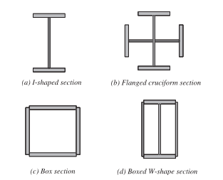

I don't have any experience designing special moment frames, but the challenge Rantamental is facing and the discussion in this thread has been quite interesting to follow. For my own education on this topic, I have been studying the AISC and NEHRP guidelines on WUF-W connections and wanted to raise some issues for discussion and to further my understanding.
1) The particular girder detail shown has 30mm thick flanges, which are slightly thicker than the 1" limitation in AISC-358. Also, the clear span-to-depth ratio (2400mm/350mm = 6.86) appears to be slightly lower than the minimum ratio of 7 allowed for SMF. In practice, are these slightly out-of-spec values acceptable for prequalification?
2) NERHP Tech. Brief No. 2 seems to discourage the use of deeper column sections: "deep wide flange
sections, particularly those with lighter weights, are susceptible to undesirable local and lateral-torsional
buckling. The performance of deep column sections is the subject of ongoing research". Wouldn't the skewed connection in this design exacerbate the likelihood of LTB? Can LTB be confidently resisted by lateral column bracing or is that one of the issues that future research will address? Is there any allowance for prequalified connections to be slightly skewed?
In a hypothetical alternate universe in which Northridge had not happened we would still have the requirements we have today. For one Kobe had similar failures in moment frames as Norhtridge, even if we assume that Kobe never occurred, the research for Northridge earthquakes connections showed these same failure modes in several tests during the 60/70. As more testing was conducted the requirements would have been developed.

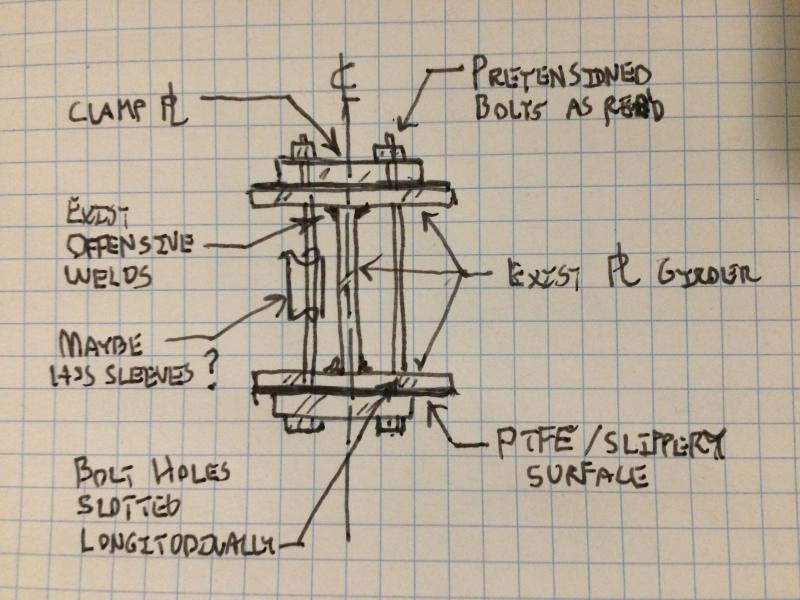

A system which removes part of the web connection to the flanges exists SSDA
Facinating. Thanks for sharing that. Sans pre-qualification testing, if basically is what I sketched out conceptually.
sandman21 said:
Your new fix would have a large impact on the capacity of the flanges, likely causing a rupture to occur at the long slotted holes.
There already exists a pre-qualified bolted flange moment connection. Seems to me that the bolt holes should be resolvable.
I would think so. Firstly, your beam axis no longer runs through the column centroid. Secondly, there would be a component about the plastic hinge moment that would now induce weak axis bending in the column.
You'll generally have two kinds of column bracing at each floor level:
1) Translational perpendicular to the frame as provided by infill beams etc.
2) Torsional provided by the weak axis bending of the frame beams and any supplementary bracing. Hopefully the frame beams are still capable of adequate torsional support once they go plastic. It's not a problem that's arisen in testing to my knowledge. It's an issue that would probably also benefit from the hinging not taking place right at the column flange face.
Between floors, the columns are usually unbraced of course unless you've got girts etc in play. That's fine so long as design assumptions reflect reality.
