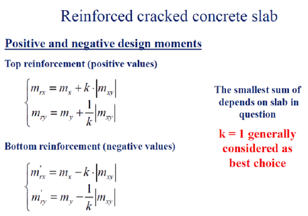

@centondollar, you mentioned a more "sophisticated" approach with FEM and adding the twisting moments according to Wood-Armer. When I Googled that I got the following:
I have to admit that I was a bit surprised by that result because I have used it many times. But I have never heard the reference "Wood-Armer" before in that context. I have only considered it as a simple and conservative method to include the twisting moment is a slab solution.
Finally: I am in Europe but I have been on the forum long enough to recognize a lot of the mentioned methods. I have also done projects both in the US and of course in Europe. My preferred method for designing a slab would be FEM. It is not perfect but it is probably the best and most general tool we have available today. Especially when working with non-linear problems FEM can be a very helpful toll. And even if the codes vary in different countries the laws of nature doesn't [smile].
