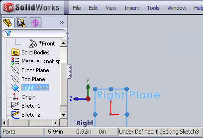

Hi All,
I want to try to solve what I hope is a basic template "problem" for those of us that use both CAD and CAM packages and do some CNC milling...I am sure this must be already been discussed and solved zillions of time s :).
I want my Z orientation in Solidworks to match my CNC mill, i.e. the Z moves up and down and is vertical to the environment, making x-y on the table plane with Y pointed away from me standing in front of the mill, or sitting in front of my computer doing the design work.
I worked with my reseller probably a year ago to re-orient my starting planes in SW to be just this....Z up and down and Y pointing away (see attachment of sketch on RIGHT plane). This was a partial fix, because unfortunately, when working in the right plane, you can see that whereas the view orientation is "correct", SW still thinks it is working sideways....most visibly, the RIGHT plane text and dimensions are sideways. More importantly, any "vertical line" is not vertical, but horizontal, you can see the horizontal relation in the vertical line in the sketch. Also, if I hit the "normal to" view button, the view spins 90 deg, and the relation corrects itself, BUT that is not the environment I want to work in, because Z is not up and down in this case (and gets confusing when setting up the mill and designing for it....). The workaround has been using the Right selection in the orientation pop-up box (lower right) and that at least puts Z back as shown in the attachment.
To get this far, I recall that I ended up deleting the original planes from the tree and creating new base planes somehow using the update or new in the orientation pop-up box....not exactly sure how now.
Am I missing as easy fix?
Paul

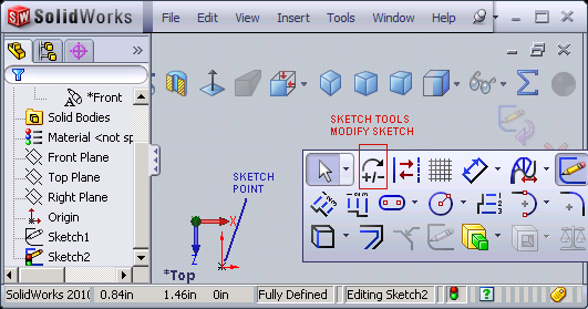

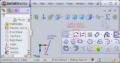

Link to 2012 HELP RE: Modify Sketch Tool
Tools > Sketch Tools > Modify Sketch

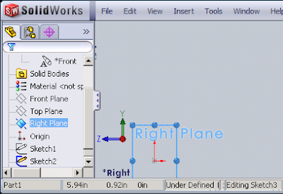

Image 1: Front X,Y default view's Hz & Vt positive directions
Image 2: Top X,-Z default view's Hz & Vt positive directions
Image 3: Right -Z,Y default's Hz & Vt positive directions

The Key Workaround is to keep the first 3 sketches empty except for the point on origin and the Modify Sketch operation.
For any additional sketches you can be duplicate one of the oriented 3 sketches by selecting the original sketch and a new plane then Insert > Derived Sketch.
Derived Sketches for the most part are used to place multiple duplicates of a complex sketch that always match the original. Before modifying the derived sketch features you can Right Click and choose underive sketch
If you create the original YZ sketch on the default right plane and use the Modify Sketch tool to correct the orientation then any Parallel Right facing plane should get the same orientation when using Derive Sketch to copy the parent sketch.
Previous post's mislinked images
