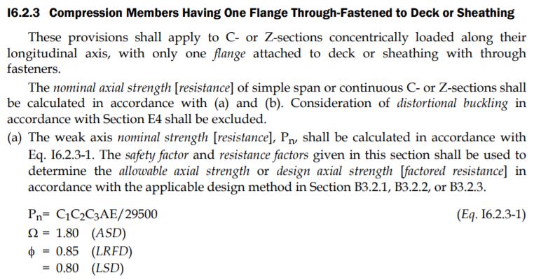

My team and I have been contracted to review a PEMB for the installation of some new exhaust fans. These fans are attached to 8" Z-purlins which are through-fastened to an R-panel type metal sheathing.
We have been utilizing RISA-3D to conduct the analysis. When running the analysis, the Z-purlins are failing according to AISI code equation H1.2-1 which is combined axial load and bending.
We believe the compression in the purlins is coming from the overall deflection of the main support/girter system and this compressive load is overstressing the member. Reading further into the AISI code, there is a provision for calculation the weak axis compressive strength for a purlin with one flange through fastened to metal sheathing. When we do this calculation by hand, it leads us to a much larger allowable axial compressive force than what RISA is calculating, approximately 7-8x higher. This value also is very close to values found in load tables/charts.
When we insert this hand calculated value into the H1.2-1 equation, the members passes unity. So my question is, could this be a limitation to the programming of RISA and we should rely on our hand calculations for this instance? I do not know of a "factor" within RISA to tell it to default to this equation for allowable axial compression as we are already using Lcomb top, etc.
Any insight into this would be greatly appreciated!
