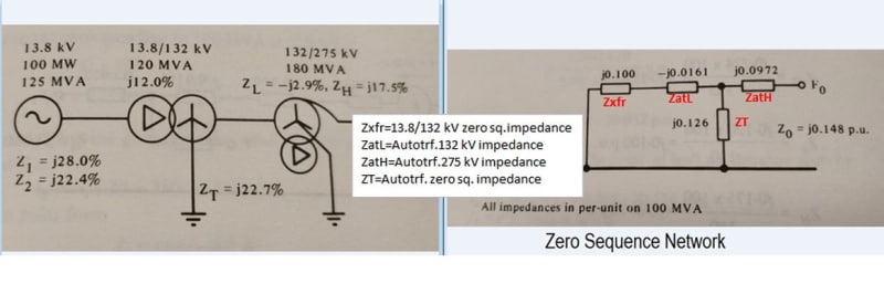

Zero Sequence Network
It does include the zero-sequence impedance of the delta-star transformer, it is the j0.1pu on the left.
It seems that ZT it is the autotransformer to ground impedance. The transformer to ground impedance is 12% [0.1 p.u.]
