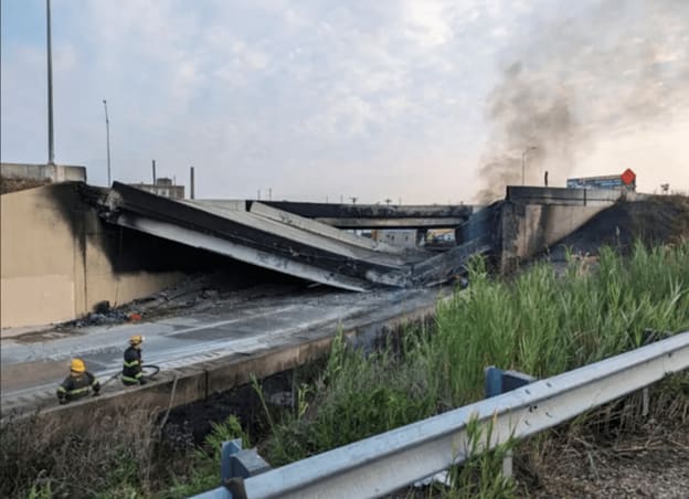

Cutting Natural Rubber or Silicone Rubber Wiper Blade
TimtheToolMan
Jan 20, 2004
28
What process is used to cut windshield wiper blades and produce a very sharp edge?
I'd bet its a really shasrp knife.
Some of the higher quality blades are cut and I assume this is after being molded or extruded. This will produce a cleaner edge.
I will now have to inspect my wiper blades. Tim, at first your statement seemed to make sense. However it is highly unlikely that the blades are produced by cutting. The fact is that it is actually very unusual to want an "infitely" sharp edge. Such an edge will wear away almost immediately. Most sharp edges are actually very small radius curves and obviously such an edge would be most desireable on a squeegee. Such an edge would be molded as it is the most cost effective way to make suach a part.
The ends of mine are not from a mold.
TTFN
You are correct that a sharp edge is not what is desired. I should have said a very smooth, flash free edge, i.e.: minimal imperfections.
Here is a link showing that Bosch makes blades with a cut edge. It is interesting that ad mentions cut is for smoother movement.
The actual product that I am really interested in is squeegee related and molded or extruded material lacks a high engough quality edge.
Before more confusion ensues, maybe it should be specified if we're talking about cuts at both ends of the wiper (setting its length) or cuts to the actual blade (edge cuts). In reading the responses so far, I could make both assumptions.
Dan - Owner
We are talking about cutting the surface that is in contact with glass, not method of cutting to length.
If I were asked to produce wiper blades with a cut edge I would certainly think about extruding two profiles in one, joined at the blade. Cut down the middle and voila, two blades with cut edges and no waste.
Last time i replaced wiper inserts i remember seeing a parting line like they were cast in a mold. They werent high quality blades though.
-Jon
Wiper blades are extruded, then cut to length. There is no reason to cut the contact edge and it would be difficult to get a perfectly straight and flat cut.
Also, I do not think that silicone rubber is used, unless it is used in a blend. If you want a quick and easy test for silicone rubber, burn it. Silicone rubber leaves a white char.
Wiper blades are extruded and in most cases they use EPDM-rubber because of its stability against ozone and other environmental influences.
It is a co-extrusion method where they extrude a hard compound and as oft compound together.
-hacki
When blades are extruded what die and process steps are taken to ensure the edge is free of defects? A small defect would leave streaks on glass.
As Compositepro mentioned, ideally to improve product life, the edge would be a very small radius. Does anyone know how small the radius is?
