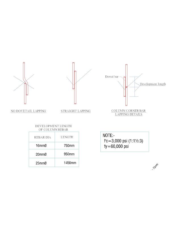

Hello,
In practical work we see that dovetail lapping is mostly used,but just now I found something different.Have a look in this image.
Now why this engineer prohibit dovetail lapping in column?If we use lapping with dowel bar,how to joint dowel bar with main reinforcement? By Welding or by Squeak?
