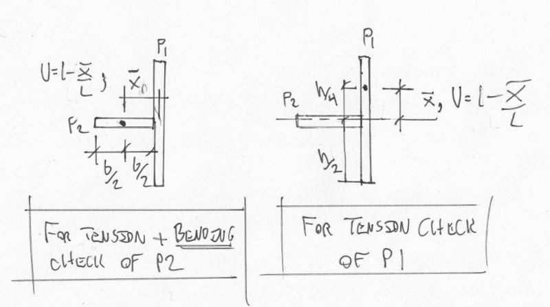

If you have a long plate (Plate 1) that is in tension, with a force of Pu (factored) and you need to occasionally have a splice in it to limit the length of plates needed in the field, and if you used a perpendicular splice plate as shown in the attached image, how would you treat the issue of shear lag in the splice Plate 2?
AISC has table D3.1, which provides various U values to reduce the effective area of the plate when checking a plate's tension capacity.
This takes the form of ΦPn = ΦAe(Fy)U.
However, table D3.1 doesn't seem to include this particular condition.
Case 2, which includes the U = 1 - x/L specifically omits plates.
Case 3 is for transverse welds, not longitudinal.
Case 4 seems to apply to a plate with longitudinal welds on both sides of the plate – not on just one side.
The other cases are all totally different conditions.
Any thoughts?

I think you could make the argument that Case 1 could be used, but I would look at Case 4 (Plates where the tension load is transmitted by longitudinal welds only). There are stipulations in Case 4 that lower U=1 to either U=0.85 or U=0.75.

laying pl 2 flat against pl 1 would be a much better splice....there is a large amount of eccentricity in the splice as shown......
I think using U=1-xbar/L is a reasonable approach, with xbar equal to half the plate width like you show. You could also check the plate for combined moment and tension, where the moment is the force times half the plate width. With any luck the two methods will yield about the same results.
I also agree that turning this plate flat against plate 1 would be a better splice. (Might your sketch be a simplification of something larger?)

I believe that it should be as I've illustrated below and that a check is required for both P1 & P2. There are three ways to get there. Using P1 as an example:
1) Case 6a with H collapsing to zero
2) Case 4 with W = P1 width
3) Case 2 recognizing that x_bar here is about vertical load spread, not horizontal.
It makes sense that there is convergence since all three cases are adaptations of the same fundamental concept. The key feature of all three, taken in this context, is that you're delivering a load that is concentric about both axes but needs to spread out in the vertical axis.
Key to this is recognizing that the flexural strength and stiffness of P2 is what enables the load to be considered to be delivered to P1 concentrically. As such, Nutte's recommendation of a combined stress check for the splice plate is important.
I know I'm saying nothing you don't know, but that's one ugly splice !
Agree with KootK, certainly the splice plate in in bending. You could do a "shear lag" analysis for the shear into the splice: I suspect a linear assumption is not too bad. FEA ?
