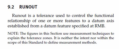

The runout tolerances are defined in terms of Full Indicator Movement (FIM), but this does not mandate that an indicator be used. In Y14.5-2009 Section 9.2, there is a note stating the following:
"NOTE: the figures in this Section use measurement techniques to explain the tolerance zones. It is neither the intent nor within the scope of this Standard to define measurement methods."
In the new Y14.5 draft, the indicator descriptions have been replaced by direct descriptions and illustrations of the tolerance zones.
Evan Janeshewski
I'm with CH - the standard actually clearly states it is not within the scope to define measurement methods. Its right there in the beginning of the runout section, see below.
looks like i posted the same answer as Evan, I was just a bit slower to the draw - my apologies!
