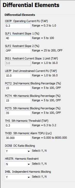

The issue I have is this can't happen every time they open the remote breaker whether for a requested outage or to add SF6 gas. The 587 is set very reasonably with a 0.3 pu and 40% slope 1 with slope 2 set to off. 2nd harmonic blocking is 15%
Is 2nd harmonic set for
# cross blocking and also is set to
# block as long as the I2h lasts (>15%).
I am not familiar with SEL relays. But, I have seen the above factors leading to relay maloperation in other make relays.

I am the commissioning engineer for the transformer, hence why I am eager to discover the issue since everyone likes to point the blame on me missing something during commissioning, so I only know enough protection knowledge to be deadly. I know there is a way to view harmonics thru the raw event files, that is just where I seem to get a little behind. I am attaching two images, one of the differential settings in the 587 and the other a snip of an event report that shows the harmonic blocking asserting. It seems like it only picked up after the 87 tripped.
There's a pretty fundamental error in the settings - the relay is set for ABC phase rotation and the system is ACB rotation. The internal compensation is going the wrong direction; getting operate currents equal to restraint current points to something pretty significant.
This is something I have been harping on as well for the past few days... You are correct the PHROT in the settings is set for ABC and not for ACB. Someone managed to tell me it wasn't an issue and I had a hard time believing that setting was compensating for the phase offset. Where I made a big mistake was during load checks I did not log into the relay and calculate the mismatch. I would of see this right away and knew something was wrong. But how in the world could this not have operated over the course of two weeks????? It just didn't see enough load?
Well, "Someone" was wrong. The compensations for the delta need to use the correct phases and they're not presently.
It's just like telling the relay that it has a YDAB connection when it really has a YDAC connection, would "Someone" have also said that wasn't a problem? That's basically what the relay is seeing, you could change TRCON to YDAC and I think it would work correctly, but then there would be two mistakes in the settings instead of none.
