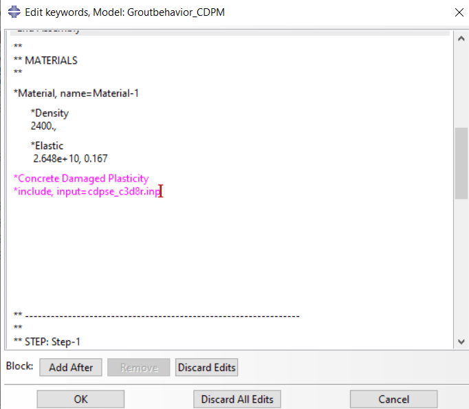

FEA way; I tried input file this way: but it gives me an error. Ive attached the steps I did, what is the right way to use an input file?

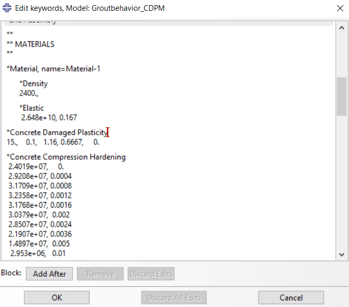

This is how it looks when I open it up:
This is what I change to:

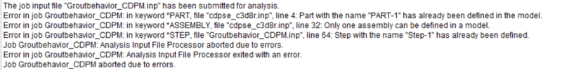

This is the error message I get:
I ve attached the data I use, I use the data for 45 MPA. I have just manually added the material data.
The .inp file that can be downloaded from the documentation is a complete input file with all the data necessary for single element test analysis (not only material data). So you shouldn’t add it to your model. Instead edit this cdpse_c3d8r.inp file and replace material data with your own. Or import this file to CAE as new model and edit it there. The latter approach is not recommended though (CAE doesn’t support some keywords so it may not import the model completely).
