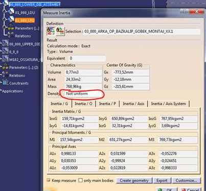

Hello,
When I want to calculate Weight with Measure Inertia for a product (Catia R24)
There is a problem just below "Not Uniform"
But if you use Catia R19 same it is possible to write value.
Anybody have any solution for this?
I can weight one part one and calculate total but time is running. Macro etc. maybe?
But maybe there is solution on tools->options
Thank you
Best regards
To get accurate weight for an assembly, you must add materials to all the solids.
Also make sure material has Density entered.
When you measure the assembly you will get not uniform if you have components with different densities.
Hello, when I want to do it, I make fist cgr from the assy and then I measure it. But as others mentioned, it must be same density for all parts. If I have big cast for example with density 7300 and a lot of small parts with density 7850 I use 7400 or 7500.

Thank you everyone,
As far as I see, If there is a part it has no solid body it is making problem for calculate weight for a product.
All parts must be solid volume then it is working.
