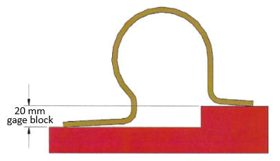

Hi all,
I have a machined part that has offset surfaces...somewhat similar to what you'd see in Y14.5-2009 Fig 4-22.
From a functional standpoint, my part mounts on offset surfaces...just like what Y14.5 shows. I attached a picture from Y14.5-2009 for the offset part.
So my question is regarding inspection of the coplanarity (profile) between the two surfaces.
How would you inspect this using a CMM? Would you need to make gage block that mimics the offset and lay the actual part on top of that? If so, how does the probe verify the profile if the probe doesn't have access?

Evaluating a feature for conformance and utilizing said feature as a datum feature for reference in other controls are two separate concepts*. Take the fig 4-22. The pair of offset surfaces must be measured to ensure they conform to the 2X 0.8 profile tolerance. Then they are utilized as datum features to constrain the translational and rotational DOFs of the tolerance zone specified by 3.0 profile to |A-B|.
Hard gauges may be utilized as datum feature simulators (stacked gauge blocks combined with a surface plate as you suggested or something custom fabricated) or if all features can be accessed in a single setup these datum features may be simulated virtually by fitting planes in your CMM software. See ( for some notes on the latter case.

So I guess I'm still just wondering how you would ensure the two offset surfaces are coplanar to .8. There's no datum feature referenced in the feature control block so would the profile act more like flatness?
If that's the case, do you set this part up on some offset jackscrews and run a dial indicator underneath?
I'm not quite understanding how a CMM could create theoretical datum feature simulators. What does that look like on the actual machine?

Yes -- think of it exactly like flatness.
Simply create a step of 20 mm (a gage block) to hold up the right-hand leg of that clamp. That sort of takes away the offset, and the theory becomes the same as flatness.

I will use a 20mm physical gage block to create the step, this will be easier and practical no matter you are checking it by a dial indicator or CMM.
Season
So when it's on the gage block - how does the probe sweep the two offset surfaces for coplanarity? Isn't the gage block essentially blocking off any use of an indicator/probe?
Set the part in a vise with the faces up. Pile on the gage blocks and adjust the item in the vise until sweeping the large one gives zero offset, just like checking for flatness would be done. Then remove the blocks. Sweeping each of the faces gives a reading that tells what the variation is, knowing that the highest point(s) of each were at the desired basic offset; to pass, the variation in reading for each face is less than or equal to the tolerance.
To be absolutely sure, use an unequally disposed profile tolerance such that all the tolerance is on one side of the gage blocks, just like the part would mate on installation.

The picture shows how we set up the datum simulator according to the drawing, what you said is ture you can't check the surface profile when the part is sitting on the datum simulator, but you can try:
1. For a guick check, you may use a feeler gage(thickness gage) to see the gap variations on the datum simulator(you can check both side of the clamp legs).
2. Take two gage blocks of same height(say 10 mm), and take another two gage blocks with same height(say 30 mm), the difference on height will create a datum simulator with 20 mm step, place the part on it and you can indicate underneath now.
