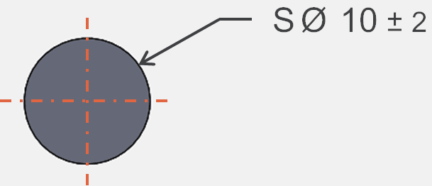

Hi all,
What is the IB of the following feature of size, to which Rule #1 applies? Is it 8 or 4 (= LMC - Max Form Variation)?
Thank you.

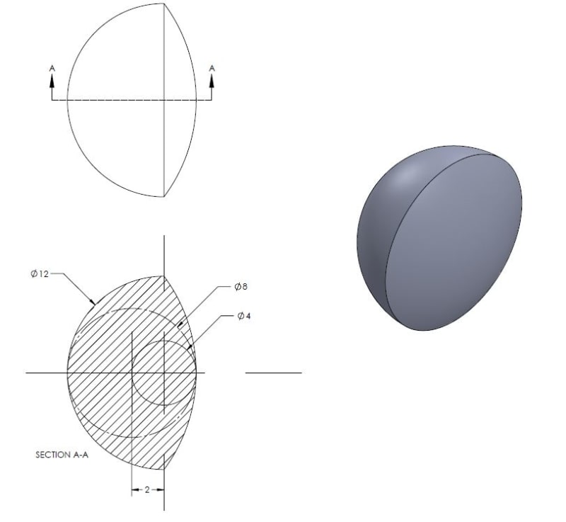

The MMC condition establishes an outer boundary of a diameter of 12 (Rule #1). Now imagine if the sphere were produced at LMC size, or a diameter of 8. Imagine that the LMC sphere is on center of the outer boundary. Consider how much that sphere can move within it's outer boundary, knowing the difference between OB size and LMC size. In this case, it can move 2 to the left before hitting the OB, 2 to the right, 2 up, 2 down, etc... The inner boundary will be the area that some part of the sphere will always remain inside, no matter how far it is translated within the boundary. You can see it with a simple 2D analogy, moving the LMC circle left, right, up, and down. I agree with Burunduk that in this case it will be 4.
The IB is generated by a combination of the LMC size and the maximum possible form error.
Imagine the sphere is produced at LMC size of 8mm, and there is an indentation at some place on the sphere, 4 mm deep, as the maximum form error allows. To maintain the actual local size requirement, there should be at least 4mm high bump on the opposite side of the sphere. However, if you inscribe a maximum diameter perfect form theoretical sphere within the actual sphere, it will be of 8-4=4mm diameter, because that's the largest sphere that is limited by the indentation. That's your IB.

I think that if there's an 8mm diameter sphere produced, with a 4mm deep dent opposing a 4mm high bump, that would conform both to the swept spheres definition and to the ALS application of size limits. However, the largest perfect form sphere that can be inscribed in the actual feature is of 4mm diameter. So the current specification can not protect an 8mm boundary.

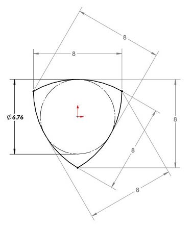

Ok, I can visualize inner boundary smaller than 8 mm:
Still far away from 4. Suggestions?
It would not. It would violate your 8mm LMC sphere. The 8mm LMC sphere must be completely inside the material.
If you believe otherwise please provide a sketch that shows it. I do not believe it is geometrically possible, but I am not infallible. I would be interested to be proven wrong.

That said, your (6 Aug 20 14:07) violates the limits of size. The 6.76mm circle you show is not possible - that would violate your LMC sphere of 8mm. That circle cannot be any smaller than 8mm, even for feature with trilobular form error.

You described it twice, but would you be so kind to draw it?
How exactly "dent" and "bump" look like?
chez311,
6.76mm is not a "size" or "measurement"
By definition, perfect form at LMC is not required, so there is no "LMC sphere" it's enough to have "LMC measurements" which are all 8mm.
