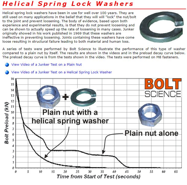

Belleville springs or something of the like would help compensate for creep over time. I don't know of any other type of lock washer that would be beneficial here.
If you google 'spring washer' you'll get many brilliant rants about them, none positive. If you've done the bolt science course they don't even get a mention in the analysis of joints bit. By the time they start to work your bolted joint is in the first stage of failure, it has lost preload.
Money quote:
"... a rationalisation of the variety of locking devices used by such major companies has occurred. For example, conventional spring lock washers are no longer specified, because it has been shown that they actually aid self loosening rather than prevent it. There are a multitude of thread locking devices available. Through the efforts of the American National Standards Subcommittee B18:20 on locking fasteners, three basic locking fastener categories have been established. They are: free spinning, friction locking, and chemical locking."
Cheers
Greg Locock
