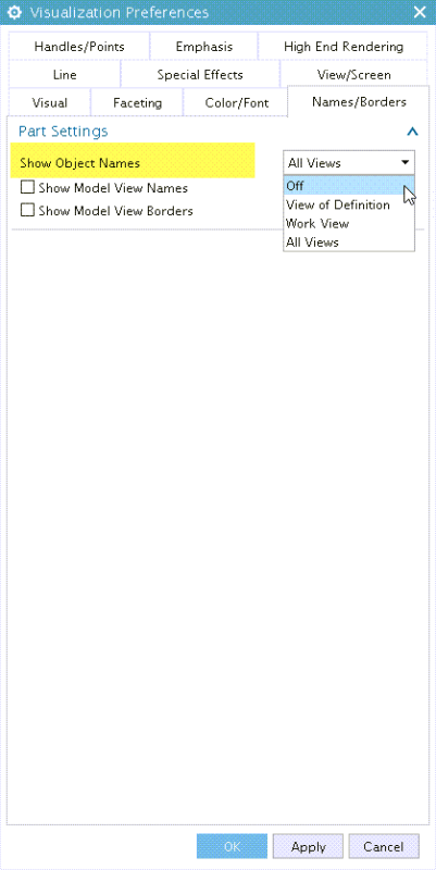

Line identification 2
Turn off object names in the Visualisation Preferences.

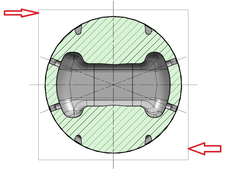

In the same way, in drafting module all views show a "box" all around the views. ¿how can I get off that?
Thanks for your comments
Tom
NX12 Windows 10 / Teamcenter 10
The "box" represents the drafting view border. I suggest leaving it on as it does not print (nor is it exported to PDF) and it makes selecting and aligning views much easier. However, if you simply can't abide seeing them, you can turn them off in the drafting preferences (view -> workflow -> border -> display). The setting is part specific, meaning turning it off in part A will not affect part B. If you create new drawings from a template, open the template and change the setting; any new drawings created from the template will inherit the setting (existing drawings will need to be changed manually).

Awesome, and thanks for your comments and suggestions, and is correct as you say "simply I can't abide seeing them".
Best regards
Tom
Another option is to change the color of the border to something close to the background but not the same. It allows your eyes to pass over them easier and yet allows you to see them when you need to find them.
Also, someone once made this journal for me. You can create a button for it and it toggles the drafting views borders on and off. So the borders are always a simple click away.
