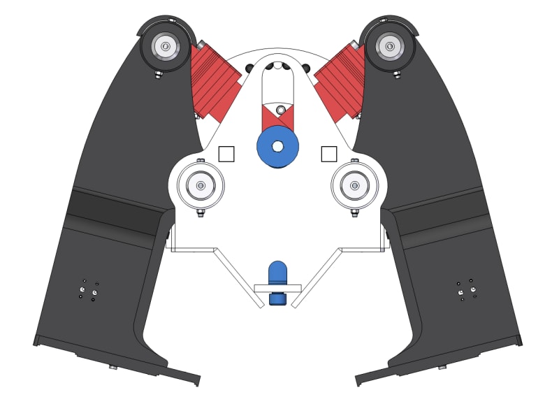

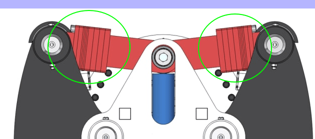

We have a construction application (Side-Grip) which is used to drive steel into the ground. I'm trying to establish the clamp force generated.
(x2) arms which hinge are driven by a hydraulic cylinder. When the cylinder is extended the arms pivot forming a clamp.
I've tested the clamp force of the cylinder on the application and recorded 64t but would like to make sense of the what's going on as we were expecting closer to 100t. There are some obvious friction point which would reduce the clamp force, but didn't expect it to be so much!
The cylinder (blue) is in the retracted position here:

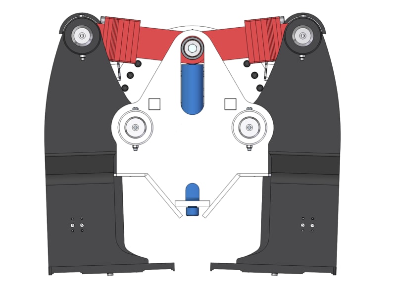

Cylinder extended shown in the image below:

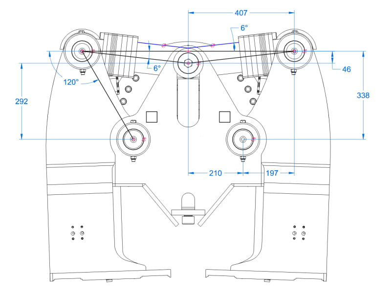

A few dimensions and angles for calculations:

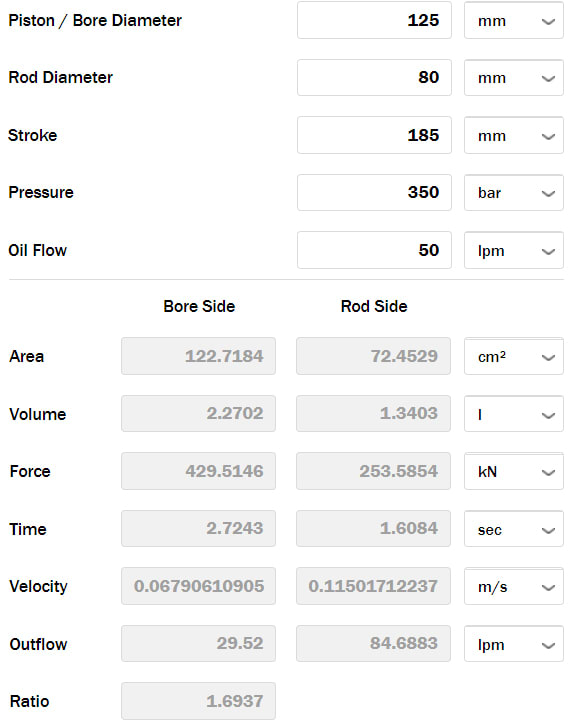

Some additional info on the cylinder (ignore flow)
Thanks in advance guys!

well if you are talking metric tonnes then you don't have sufficient force in the cylinders, you need 490.5kN on the full bore side of each cylinder. Also then the mechanical advantage of the clamp will reduce the clamping force due to the arms being longer than the pivot arm to cylinder. What is the distance between the pivot and the clamping point. looking at the mechanism I would say 64KN was about right.
Thanks for getting back to me.
Yes, I'm talking about Metric tonnes. You're quite right regarding the cylinder force. Appreciate it.

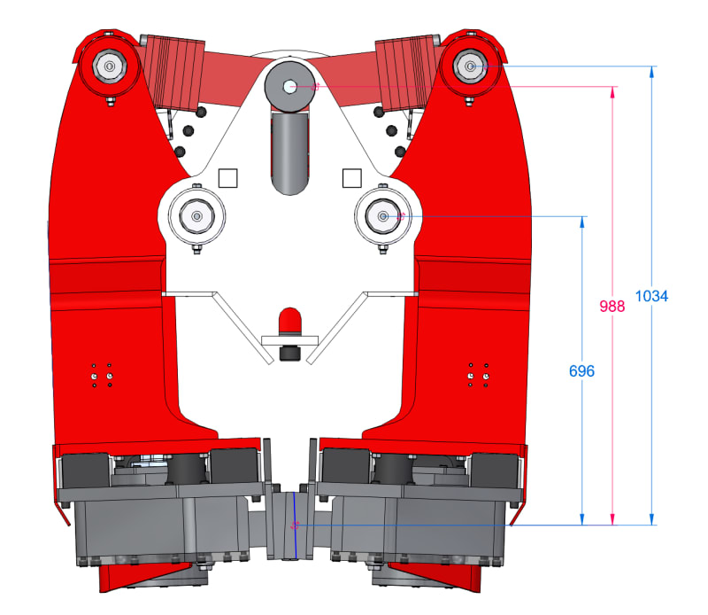

Bit of an odd scenario; the company I work for purchased this application for further development. Unfortunately the CAD we received doesn't match the actual item. It appears the clamping part interferes in this image, but this is not the case in reality. The measurements from hinge points to Clamp are shown below:

Hi MintJulep The plates inside the arms are to allow adjustment. We can add or remove these depending on the size of what needs to be clamped. Typically clamping steel up to 20mm thick between the jaws, however large tubes need to be handled at times (700mm OD). We realise this significantly alters the clamping force.

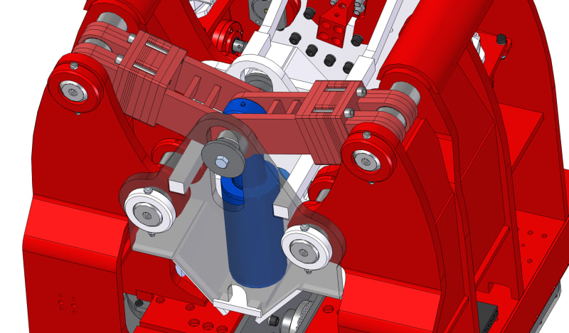

I've hidden a few parts for clarity in my previous images. Please refer to the hinge / arm mechanism in the image below:
Hi Mark 555
According to my calculations when the arms driven by the cylinder are at 6 degrees I calculate a clamp force of around 992KN however when you grip various thicknesses of steel that angle of the arms will change and as a result of that so will the clamping force, what sort of thicknesses do you clamp ie max and min?
One issue is that the device is adjustable, so how accurate is the 6 degree value? The device is capable of theoretically reaching infinite clamping force.

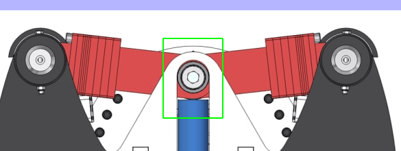

Is the roller bottoming out in the slot? Maybe some oil pressure on the rod end of the cylinder?
As Compositepro said, the linkage gain goes to infinite as the upper links get close to horizontal. Same with sensitivity (Clamp force/Actuator force). If the link loads are getting high then maybe the horizontal bearing loads are getting high. Also everything will deflect more when the load gets real high so maybe the geometry is off a bit.
Is the upper roller side load path stiffer than the actuator side load stiff path? Looks like it would be unless there is slop in the fit to the slot.
although from the later pix it looks like the grippers bottom out before the links are horizontal ... the clamps touch with a reasonable angle in the links.
