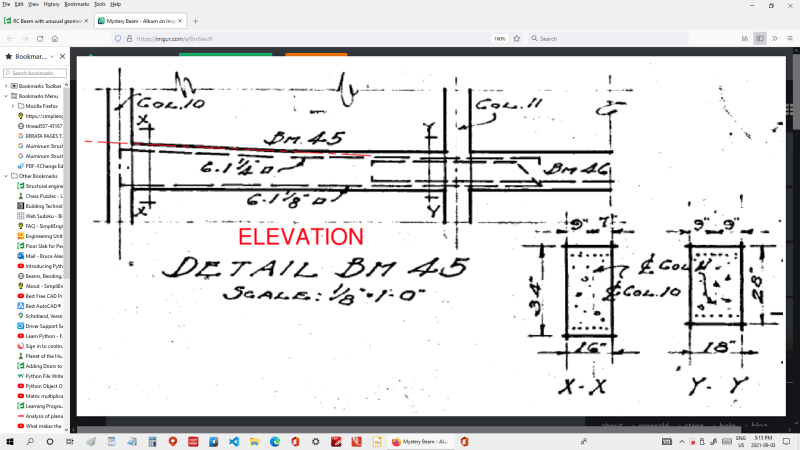

I have the original drawings, and have come across an unusual concrete beam.
Below is an imgur link, because I couldn't get the attachements to work:
Image 01_Beam Detail shows a detail view of the beam.
The beam is nonprismatic, 16"x34" at one end, and 18"x28" at the other.
There are other irregularities found in the detail as well.

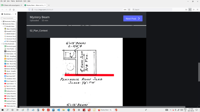

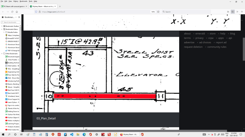

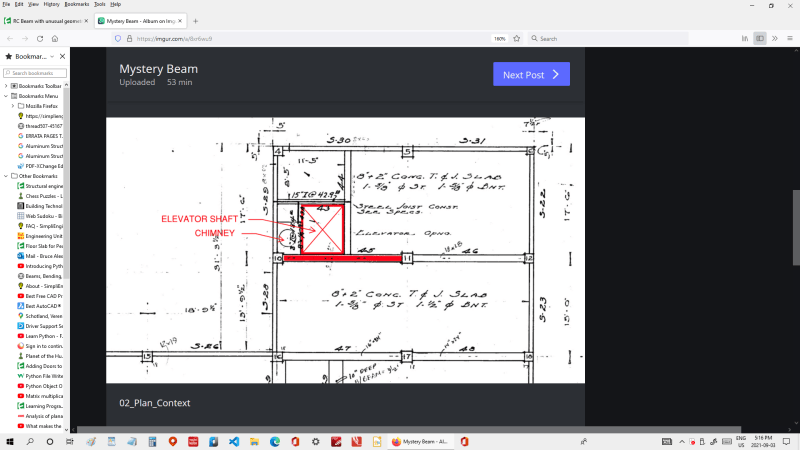

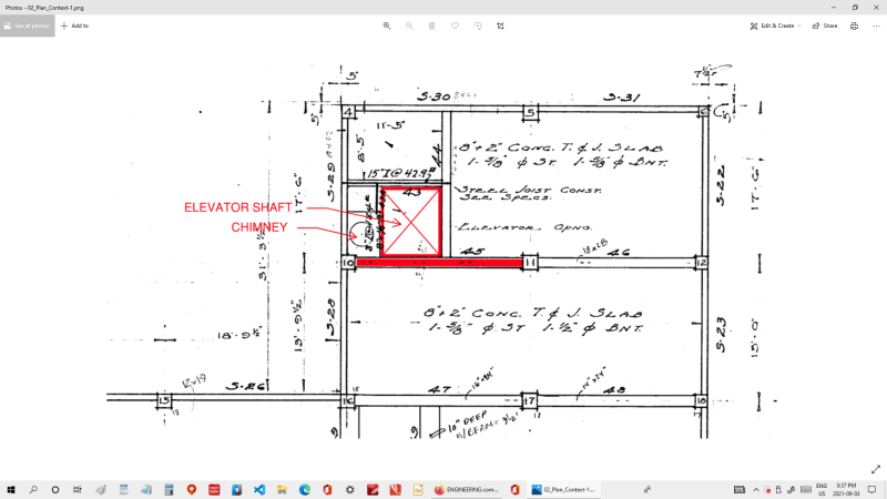

Images 02_Plan Context and 03_Plan_Detail show the beam's location. It is a roof beam, adjacent to an elevator shaft and a chimney, below a penthouse.

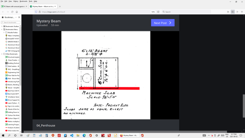

Image 04_Penthouse shows the penthouse plans. The mystery beam's location is highlighted in red. It would be directly below the penthouse.

Something to do with drainage? Keeping water away from the lift shaft somehow?
The increase in beam section coincides with the cutout for the lift shaft/chimney.
Are other floors similar? I.e. Is it used to redistribute load around the slab cutout?

Where does the width change? You kind of imply a width taper, but I don't think that's true at all.
Seems to me it's more likely you get an abrupt change in the width at some point, likely coinciding with the beam coming in that trims the elevator penetration?
Note how the centreline of the column 10 is off centre on the beam on the section, but it isn't shown the same on the plan (I believe the plan isn't quite right here), and at the elevator you lose 2" of width on the shaft side as implied on the section. Seems perfectly normal to me.
It would be very odd to have the width taper. The only reason I could think of was to allow the beam bars to spread out to get between the column cage or something, but then wouldn't you have the same thing going on at each end given columns appear to be similar size (but may have quite different reinforcement layouts).
Overall, beam seems 2" narrower on one side as you get to the lift shaft, which seems relatively normal change to maybe accommodate the shaft.
The chimney does seem like it might be related.
However:
At lower floors, there are beams in this location. These beams are all L-Shaped or rectilinear.
If a beam of larger section might have been needed, but they chose an unbelievably labor-intensive way to to do it. An 18"x34" beam (the larger dimension of each end) would have been way easier to build than the complicated non-prismatic beam.

"Where does the width change? You kind of imply a width taper, but I don't think that's true at all. Seems to me it's more likely you get an abrupt change in the width at some point, likely coinciding with the beam coming in that trims the elevator penetration?" | Best, simplest theory so far. IF the beam does change in width abruptly, there cannot be continuous rebar in the wider part, but i suppose the width change could just be to fit with the shafts.
"Note how the centreline of the column 10 is off centre on the beam on the section, but it isn't shown the same on the plan (I believe the plan isn't quite right here), and at the elevator you lose 2" of width on the shaft side as implied on the section. Seems perfectly normal to me." || The plan is definitely more diagrammatic than literal, so this might be the case.
