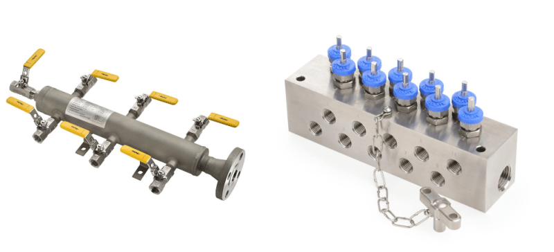

I would suggest making your manifold larger in cross section, and using a larger hole in the center as well as longer so that you can stager the branches further apart. These should help reduce flow interactions.
Drodig,

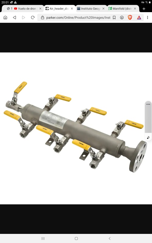

I'd recommend just making the "header" larger (say 2x or so the combined cross-sectional area of all your outlet tubing) as well as just making it a normal pipe. Then just weld thread-o-lets along the length of the pipe in the size and orientation that you need for your threaded Swagelok connectors. Welding the Swagelok's outlets along the length of the header avoids the need for making the pipe large diameter to accommodate all of the outlets.
If you do this, you can apply a normal piping code like B31.3 Note that the low temperature will require specific materials and/or tests as called out by B31.3 or other design code that you use. The good thing about using an existing piping code is so you don't have to re-engineer from scratch the header's pressure & temperature limits for a specialty geometry.
What is the pressure and flow rates you need?
Headers typically look something like this. Is there a reason you are reinventing the wheel, making swedgelock machine gun things, drilling and taping bars, etc?

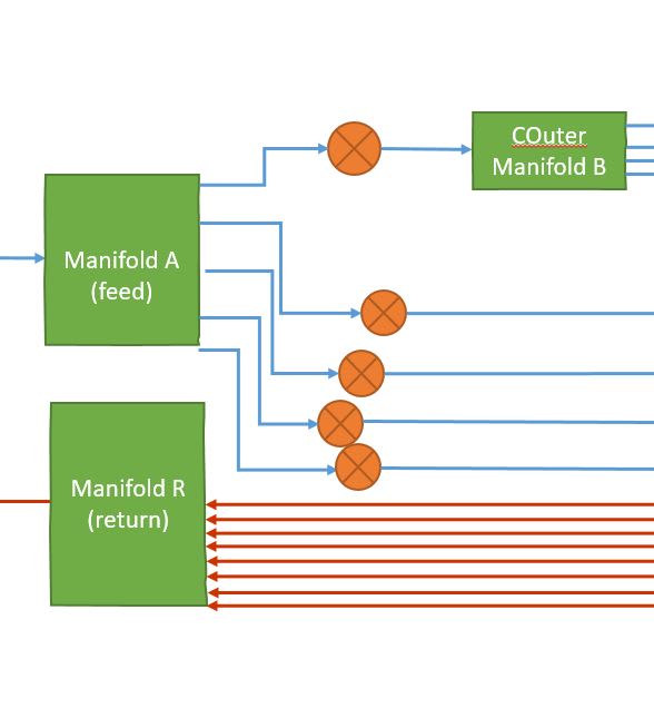

The idea is having 3 manifolds:
- One manifold in the feed with five branches out. Big flow in, distributed out
- One of these branches will go to another manifold, which has 4 branches (going to 4 exact cooling elements)
- 1 manifold in the return collecting all 8 lines back
All branches will be working all the time. We are thinking about installing electro-valves; but to be honest we can't check the flow in the branches (apart from theoretical calculations). What is the advantage of having the valves in the return line?
The flow is 20 liters/minute (=317 gallons per hour) and the pressure will be maximum 3 bars (=44 psi)
I see the point of increasing the cross section and separate the outlets. I also see in the Parker website the options, but now I wonder if the block or pipe:

If you want all 8 lines to have the same cooling rate you will need to be able to measure flow in each one and have some sort of balancing valve on each line.
Getting equal flow on such a network without automatic flow regulating valves is next to impossible.
As drawn your top 4 lines coming form manifold C will have a lot less flow than the other 4 if they are same size and similar length.

We don't need the exact same flow, but I see the point of the 4 lines top lines (coming out of the COuter Manifold B)
I will increase the pipe diameter between manifolds A and B (with regard to the other 4 -lower- lines coming out of Manifold A) so the flow gets bigger)

Or just tee your incoming line and make the branches the same length to feed manifolds A and B if they all use the same flow in each of the lines.
But getting 8 lines to have anything better than 50% flow difference is not easy. one line will get a lot more and one will get a lot less. Balancing them is difficult.
I have to double check the numbers, but in principle the 4 lines coming out of Manifold B need more flow than the single lines out of Manifold A.
Wouldn't be better to have a bigger pipe from A to B to have more flow out of the B lines?
Playing with the valves in the return, wouldn't this help controlling the flow?
cheers,
In that case feed manifold B then feed Man A...
Yes but you're playing with eight valves... Every time you change one valve it affects the flow in the other loops.
ok
I will swap the positions of the manifolds A and B
