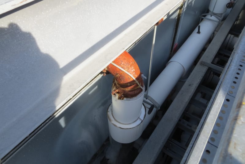

I have an unbraced W18x65 beam spanning 35'-3". It is supporting 3 pipe hangers on the bottom flange. The hangers support an insulated 6" or 8" pipe. The top of the pipe hangs down about 45" below the beam and turns up and into a cooling tower. When you push on the top flange laterally near the middle, it starts vibrating laterally.
Well, the pipe is leaking at the flange connection to the cooling tower. I can stiffen up the beam with a C12 cap channel with the flanges turned down. I am not certain this will fix the problem.

Thanks for the comments. The building is only 4 years old!
The center-line of the beam is about 9" to 9.5" from the face of the cooling tower. The pipe is 45" clear and directly below the beam. It runs parallel with the beam and it is not braced. The end of the pipe turns 90 degrees up vertical for a short distance below the beam and then turns 90 degrees from the beam horizontal into the side of the cooling tower. The leak is at a flange where the water goes into the cooling tower. The picture shows the pipe, 2 hangers and the beam above.

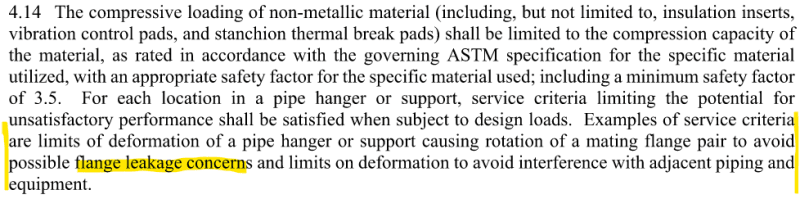

Here are some excerpts from MSS-SP-58 for reference. The table is for nominal max support spans of horizontal pipe.
Thanks Bones for your posts. I think I will suggest a Piping Engineer. I would guess the supports are about 10 feet apart now. Spring Isolaters in the hangers might help the beam.
Would you believe the building is only 4 years old looking at the photo?
Yea looks like there is some galvanic corrosion going on.
