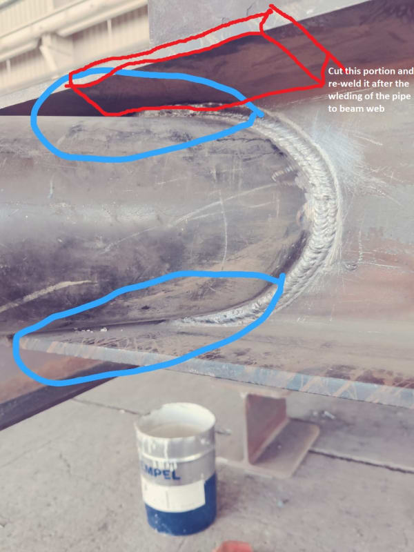

Hello,
As per the image below, it is difficult to perform complete welding of the pipe with beam's web plate, hence the client is recommended to cut some portion of the top and bottom flange and complete the welding of the pipe with the web plate of the I beam, then re-weld the portion again (CJP) on the top side and bottom side of the flange.
So the concern is we do not want to do as per the recommendation, we have carried out the welding as per the below image. so I need to justify why client recommendation is not technically possible.
Please advise.
Thank You.
A drawing or sketch would help, but is the web still complete - i.e. is the pipe butted up to the web or does it go through it?
Where is the bending or forces?
Doing your welding won't be good if there is a bending moment on the joint.
I agree with LittleInch in that we really need to know more about the loading characteristics. What is this used for exactly?
One thing for the complete pen weld is that you would need a backing bar near the web face since you wont be able to access the area to back-gouge (in order to be a pre-qualified weld anyways). And I don't really see how you could do that since you'd be right up against the weld you just made around the pipe.
In general, I do think that what your client proposed would have been technically possible so long as:
1) The beam is load relieved prior to welding which would have been necessary for your approach anyhow and;
2) There would have been physical space for the weld between the top of the pipe and the underside of the the flange. Or a slot in the flange to permit that somehow.
Is that existing weld between the pipe and beam flange actually weld standard compliant? Those are some tough welding angles and positions I would think. To your credit, they look great visually.

Is this pipe under internal pressure? If so, this is not a good solution.

I think the solution you have executed is a valid alternative, and I agree with Koot, it sure is visually pleasing.
However, we don't know the loads.

Is it because there is (4 times) a weld longitudinally, so potentially enforcing hoop stress fracture? If not, could you elaborate?

My point is inspection.
1) How is the inspection of the original weld, now hidden with the pad, during service?
2) I cannot see the threaded hole in the pad to perform a pneumatic test, or to check for any leaks under the pad during service.
3) I don't know if PWHT (thickness of welds?) is required.

It strikes me as odd if that pipe were used for medium transport, because it is welded (fully moment-fixed) to a structural beam. I'd guess it is a structural hollow section. If indeed it is a pipeline, I'd fully agree with you!
