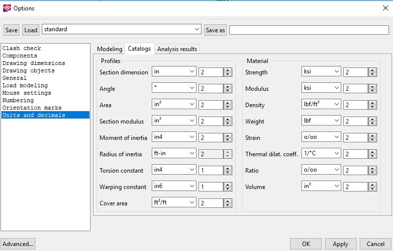

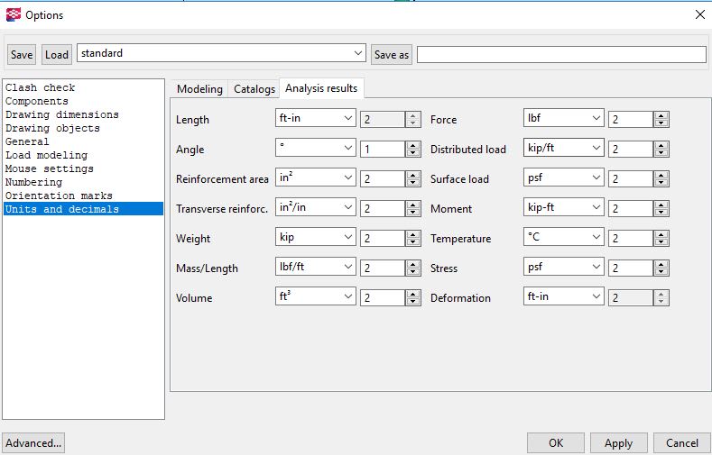

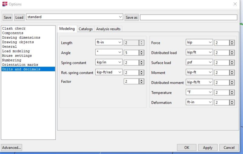

Hope it may help you..refer to the below snaps for imperial units. Please let me know if anything is wrong.
Thanks in advance!!
