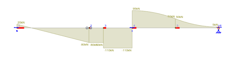

I have just been brushing up on my structural analysis. I picked an example problem from a text book to draw a BMD and SFD.
This is the problem I picked:
I undertook a hand calculation as follows:

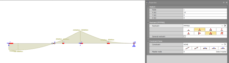

I am confident the solution is correct but thought of double checking it in a modelling software (Strand7). I have not used strand7 before and its a bit of a learning curve. I have used SpaceGass in the past but I don't have access to that software.
I modelled the problem like this:
When I ran it I got an error - "Singular Matrix". I knew immediately that the issue must be the two ends that I have released rotationally. I released them cause I wanted to mimic a pin connection as the question asks. If I remove the rotational release, the model works and produces an output. So I know for sure it is that pin connection that is causing the analysis to halt.
What am I doing wrong in the model? The way I have modelled it with that pin connection is probably forming a mechanism.
Any thoughts and advice please as to where I could be going wrong?

If I remove the rotational release on either side of node 2 then the solution works. However to mimic the pin connection at node 2 I released the rotation around the z-axis. When I run it, the solver says the following:
"Global stiffness matrix singular at equation 26 - Pivot = 0.000000E+00 (Node 2 RZ)."
So its definitely not liking the release about the Z-Axis. I can't work out why.

Are you releasing both beams at Node B? You can't do that because the node would be free to rotate. Even though nodes don't exist in real structures, they have to be restrained in the model, so just release one beam or the other.
You solved it! Yeah I was releasing both beams on either side of B. I restrained one side and released the opposite side and it solved the issue. I got the same BMD and SFD as my hand calc.
Now I understand why we can't release both sides - because the node will be free to rotate and the whole thing would form a mechanism. But in reality wouldn't you expect that the beams on either side of pin connection at B would be able to rotate?
Thank you very much for pointing me in the right direction.
It's a by-product of the stiffness method. Displacement and rotation of the nodes are calculated by finding a position that satisfies all the member stiffnesses simultaneously. If there's no restraint from members, stiffness of the node is zero and its position (rotation angle) can't be calculated = no solution.
Some software will try to fix this by applying a very weak spring to unstable nodes. If the node rotation is still small (basically infinitesimal) then the instability wasn't critical. Maybe Space Gass does that because it looks as though both beams were released in that model too.
steveh49 beat me to it.
Note that the ends of both beams are free to rotate when one has a released end restraint, because the other beam has nothing restraining rotation.
Also for a 2D analysis go to Cases-Freedom and set the freedom conditions to 2D beam XY (or as appropriate for coordinate system), then you don't have to worry about restraining Z deflections, or rotations about X and Y.
