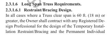

they may need an engineer for long spans. from ANSI/TPI 1 -2014
Oh I agree that permanent bracing is the EOR's responsibility, the temporary bracing is not.
However, as per kipfoots quoted clause, if the truss are longer span, that temporary bracing also needs to be designed by an engineer. But to me that should be an engineer acquired by the contractor.
The requirement has been in the IBC since 2009. But note that it says the Owner shall contract with any Registered Design Professional to design the bracing. In my experience, bracing is typically designed by the truss engineer and then the bracing loads that are imposed on the primary structure are reviewed by the EOR. But that is not the only possible method of satisfying the requirement though, as long as some registered design professional is contracted to provide the bracing design.
