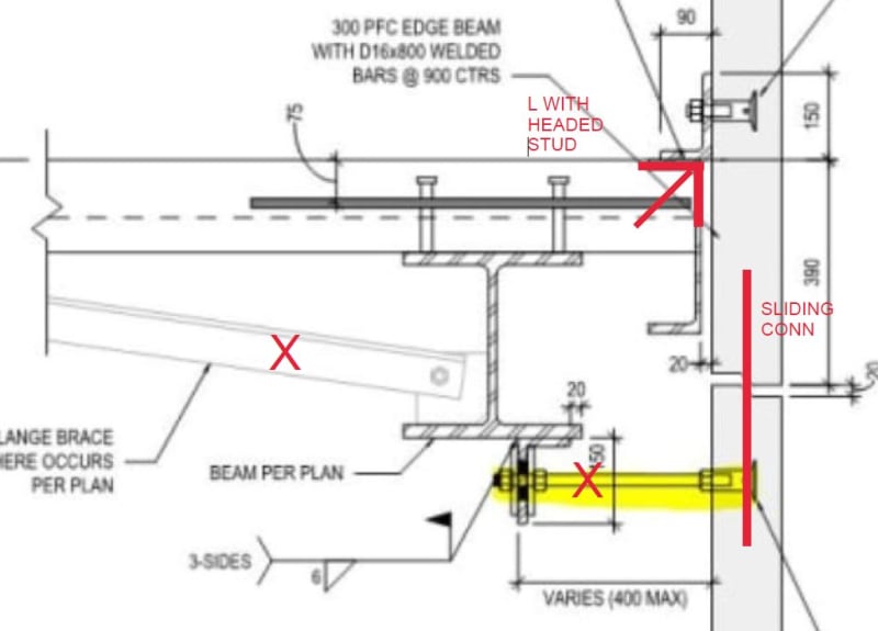

I'm working in AUS/NZ. I've got these tension-compression rods which are supporting precast cladding panels under faceload. The issue is that I need these things to be good for 60minute fire rating. How can that be checked? I tried to use formulas in NZS3404 section 11.6 (snap below) -but I only get 15mins or so. Can these things be intumescent painted? Has anyone done this before?
the detail:
![Capture_rtaml9.jpg](https://res.cloudinary.com/engineering-com/image/upload/v1665702186/tips/Capture_rtaml9.jpg)
the detail:
![Capture2_ohkko9.jpg](https://res.cloudinary.com/engineering-com/image/upload/v1665702375/tips/Capture2_ohkko9.jpg)
