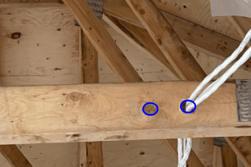

Greetings to all,
An architect called me with an issue at one of the projects he's managing. Apparently the electrician drilled a 1" dia hole through the bottom chord of the trusses. The bottom chord is a 2x4 (1.5" x 3.5"). The truss manufacturer does not want to evaluate this, as their instructions are clear that no holes are allowed in the trusses.
I checked the truss calculations, and the bottom chords are loaded at about 0.35-0.55 MAX CSI, mostly at around the 0.35 mark. The architect told me he sees this often, but from my experience, I haven't come across something like this?
With less then 2" edge cover, I am concerned about splintering at these locations.
Wondered if you guys came across something like this and how you dealt with it ? The electrician did this through most of the truss bottom chords!
Thank you as usual for all your help!

Not related to the holes, did they leave those trusses out in the mud for a month? It's rare to see roof trusses with those splits and water stains on them unless they were mishandled prior to erection. I'd be real careful about approving anything having to do with those.

That is pretty promising, particularly given that the holes are uniformly at mid-depth.
One difficulty that I have with the %Utilization business is that, in a way, I feel that it has the potential to mess with the original grading on the lumber. The hole will sort of be another knot from a fracture mechanics perspective. This might also give you and avenue for evaluation. If the grading rules would have allowed two knots in close proximity as shown below, then it's probably not a big deal. The grading rules on lumber make it such that we're assuming that some of the cross section is missing when we do T/A + M/Sx.
As for a potential repair, one might do something like the sketch below. Along with this would come my disclaimer to the client that I'd not be held accountable for the deflection performance of the trusses. This would be a belt and suspenders, strength only thing. Owing to fastener slip and pretension in the chord, I can't see the repair kicking in until after the chord is fractured. You might also give some thought to the potential consequences of the trusses going into net uplift and putting the chord in compression. It would surely be fine before a tension rupture. Less so after.

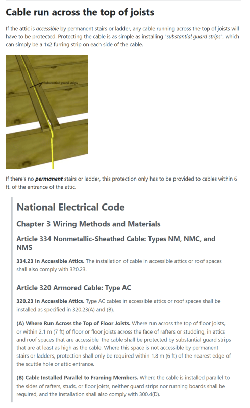

Apparently, occasionally inspectors here in the Toronto area let some contractors get away with doing this and this electrician thought it was ok! He thought by code you were not allowed to secure the wiring above the truss.
Thanks for sharing that. I was wondering how that particular choice got made.
I believe that the wires cannot be loosely just ran above the bottom chord. They need to be stapled to every truss and prevented from becoming a tripping hazard. Or at least that's how it was explained to me.

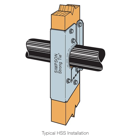

Along with what others have said I'd recommend installing a Simpson Stud shoe at the hole as well, Link
This will:
- add some additional load transfer across the region
- protect from someone drilling into the electrical line once finishes are applied.
My NEC is a little rusty, but I think there's some truth to the not being able to attach it over the truss. If you do, then you have to essentially build a box around it or otherwise protect it so nobody walks on it. Walking on a wire like that can cause chafing at the staples, shorts, and potentially fires.
I believe it depends on accessibility. Regardless, one should read or ask before drilling holes in a truss.
