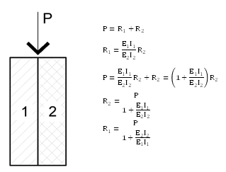

If they are truly bound together to have equal displacement then you can solve this by determining what the proportion of load carried by either member is then solving that member under those loads for deflection. You should find that following the same approach on the other member gives equal deflection otherwise something has gone wrong.
Curious what proportion of the load you have assigned to each member, or just all to the LVLs?
As driftlimiter said, if they're setup correctly, then they take a portion of the load proportional to the stiffness of each component.
I usually just figure out the percentage of the total load that goes to each component and then analyze each as separate beams. The resulting deflection for each will be equal.

For two wood beams, I would keep it simple and just add up EI beam1 and EI beam2 and run the deflection calc with a combined EI. The different stiffness is accounted for by the different E's.
I wouldn't say alot, a 1.75 x 9.25 LVL (2.0E) is only 46% stiffer than a 2x10 (1.6E).
Yea I suppose your right kissymoose, even with that extra 42% stiffness I'm getting that it only carries around 20% more load

Well that's interesting, it should be carrying 42 46% more load if it's 46% stiffer. How'd you get to 20?
I set EI of the 2x10 to 1 and EI of the lvl to 1.46.
2x10 factor is 1 / (1 + 1.46) = 0.407
Lvl factor is 1.46 / (1 + 1.46) = 0.593
Difference = ~ 0.6 - 0.4 = 0.2
I did do this totally back of the napkin. Normally I would just calculate midspan deflection of either beam under a unit load and use K = 1/delta for this weighted average.
Got it, thanks for sharing.
It takes 20% more of the total load, 46% more than the load of the 2x10.

Your first reply was very helpful. I was able to run the numbers and get my deflection to match in this fashion.
I tried doing the same by getting an E*I from sectionproperties's library functions, but the delfection I calculate with this combined E*I is way off deflection wise when I use it. Curious as to why this is.

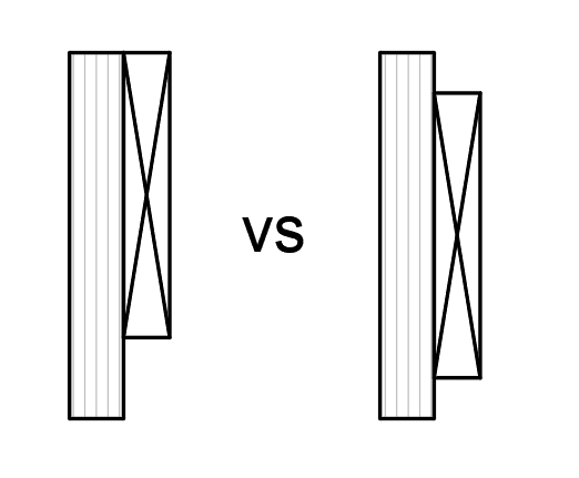

I'm gonna guess you analyzed it like the left condition, but we're talking about it behaving like the right condition, despite it likely being constructed to look like the left. On the right, both members bend about their individual centroids, where for each member, the top compressive stress is equal in magnitude to the bottom tensile stress. To behave like a single, composite member as shown on the left, the members would have to be fastened together to behave as one, where the strain at any point is the same for each. The composite member will have an increased I, smaller deflection, and put more flexural stress in the bigger member than the condition on the right.
In my specific example that I tried the combined E*I, the depth of the members were the same (2x10 sistered with 9/14" LVL) so the centroid would be the same for both, and they would still be acting individually about their own axis. I'm just curious as to why it doesn't compute the same as doing the force splitting method in your screenshot in reply #2.
