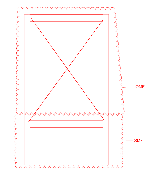

BTW, I'm not looking for solutions or alternative ideas - simply asking if this logic checks out.
The height of the frame is around 45ft. It exceeds the 35ft limit for a multi-story steel frame for OMF. It would change the architectural look of the designer's ceiling to do a SMF all the way up and deal with bottom flange bracing on the top beam at the roof. We want to avoid Simpson's specialty product that doesn't require bottom flange bracing. So, can we do an OMF on a SMF (we can do bracing at the floor level easily) that share the same columns? Obviously the R of 3.5 tracks into the SMF, but the goal here is to fall underneath the provision of a 65ft single story OMF by having it stack on an SMF, and avoid bracing on the top beam. Does this logic check out?

And I am meeting the guidelines for an OMF, because by making the OMF a single story frame, it is permitted up to a structural height of 65f (considering that the OMF is only the upper half).
KootK said:
What is your logic?
This is a seismic D category structure. Thereby, OMF is not permitted except in the exceptions.
1) The first exception of ASCE is it can be a single story OMF, up to a structural height of 65ft. I can't accomplish this structure with this provision because I need a two story frame (definitely need the lower beam).
2) The second exception of ASCE is it can be any configuration of OMF (two, three-story even) up to a structural height of 35ft. I fall outside of this exception because my two story frame exceeds 35ft in height.
The idea, therefore, is to still have a single story frame to meet the 65ft limit by stacking it onto a SMF. To me this doesn't seem any different than if I were to make the base level concrete and put a single story OMF on top of it (which I can't because windows). But the weird part with this structure is sharing columns - does it get weird for an OMF and SMF to share the same columns? Would we feel differently if I made it a pinned bolted column splice connection and it wasn't a continuous column?

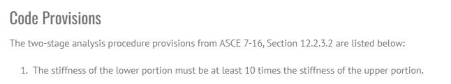

Setting aside behavior, a two-stage analysis is a code-compliant way to accomplish what the OP wants to do. I doubt it will work for single story OMF on SMF with shared columns. As for whether a two-stage analysis could / should be applied to this condition, this article offers a good discussion: Link.
Deker said:
...a two-stage analysis is a code-compliant way to accomplish what the OP wants to do.
That sound nuts to me (the concept, not you). Can you direct me to something in the code on that such that I might review it? The more specific, the better. Clearly I need some re-educating.
Stiff on top and flexy on the bottom is basically soft story, right?
[sub]That's a horrible idea. What time?[/sub]
Does this provide clarification in what I'm intending for "structural height"? I'm not trying to restart the height at the top of the SMF, I'm trying to ensure that I can use a single story OMF within the 65ft limit. The hope is an SMF below will help accomplish that by essentially remove the lower story of the OMF, same if I made that lower story concrete or whatever. I'm not trying to do a two stage analysis here, which I wouldn't think is required for simple vertical combinations of LFRS.
I doubt you need re-educating. To qualify for two-stage you do need flexible over stiff. Not likely the OP could qualify with the proposed system. The article I linked above discusses how a two-stage analysis could justify something similar to what OP is proposing, but also discusses how that is likely a misapplication of the code.
