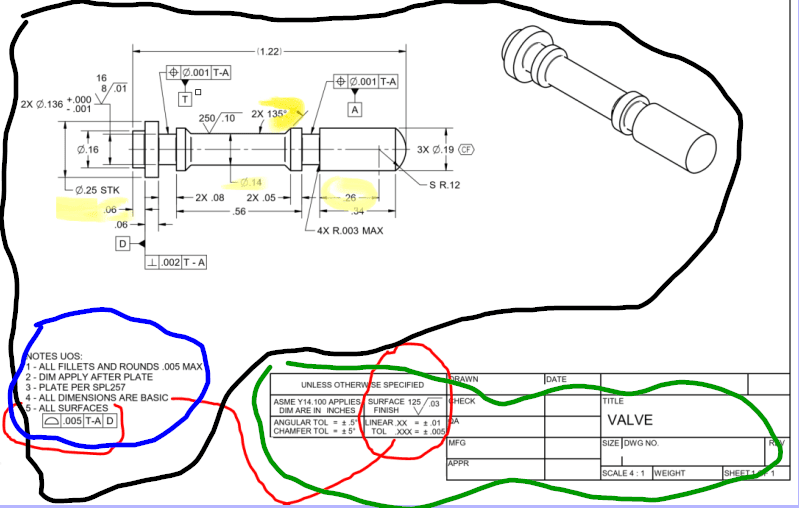

How to interpret those dimensions ?
aniiben
May 9, 2017
165
Couple of questions:
1.) If drawing shows ASME Y14.100 only, should I understand that rule#1 is enforced? Or only if ASME Y14.5 invoked directly (shown on the face of the drawing) implies envelope principle being in charge?
2.) How to interpret what tolerances are applicable to the dimensions in yellow:
a.) 135° angle is basic or is subject to angular tolerances shown in the title block ±5°
b.) Which dimensions are subject to linear tolerance xx = ±.01 and xxx = ±.005? I underlined in yellow some of the examples, but you can chose any dimensions shown on this print.
c.) By the same token as point b.), which dimensions are subject to chamfer tolerance = 5° (title block tolerance)? Is ±5° tolerance applied to 2X 135°?
Full disclaimer. This drawing is from an ASME training material from a rebutable source (and I am NOT assuming "the source" is NOT correct), therefore I am not thinking that the source/the author is not aware about the Y14.5 statement on 2.1.1.2 /ASME Y14.5-2009

Hi, aniiben:
BASIC dimensions by themself have no tolerances. The default tolerances in your title blocks do not apply to them. You will need to evaluate them according to note 5.
Best regards,
Alex
For this drawing's specifications to be unambiguous, there should have been no general ± tolerances in the title block (or notes).

The note "ALL DIMENSIONS ARE BASIC" is also technically incorrect, because there are dimensions clearly indicated not to be basic: a quick glance reveals 2 toleranced diameters, an overall length indicated as reference, a stock dimension, and a single limit radius that applies in 4 places. A better note would start with "UOS" or state "UNTOLERANCED DIMENSIONS..." which would indicate more clearly which dimensions are to be considered basic.
Burunduk,
I don't agree with your assessment in at least in one point. If you remove the linear tolerances then how would you understand 3x Ø19 CF dimension? At least know (without removing it) I would say Ø19±.01 applies. I don’t think CF used with the profile|.005|T-A|D| is the right thing to do.
Then would you understand Ø16, Ø14 for the outside diameter as being basic?
I highly doubt that is the correct way to read this print. Not sure you agree 26 should be interpreted basic, also maybe 34, but not .06.

I agree with Burunduk that the note should say that all untoleranced dimensions are basic, not all dimensions. I also agree with greenimi that the <CF> annotation would only make sense if the .19 diameters are directly toleranced, not if they are controlled with basic dimensions and profile.
It appears that the drawing was originally made with directly toleranced dimensions and default tolerances in mind, and then notes 4 and 5 were added without really considering the conflicts that are created.

.26 which locates the center point of the spherical radius is probably the dimension that needs the most to be basic. .34 should be too, and why not the two .06 dimensions?
Even with the CF problem, I would still say that the general ± in the title block contributes more to ambiguity than to making the drawing well-defined.

If the ⌀.19 diameter of the interrupted feature is to be interpreted as ± toleranced, then it's location is undefined, other than as you noted, the internal location between its segments which would be governed by CF (and it's meaning regarding rule #1).
If the feature is controlled by the general profile, it's location and orientation limits are defined relative to the T-A, D datum reference frame, and also the size and the form are under control by the same profile tolerance. The power of the general profile tolerance when it is related to a DRF is that it can fully define any feature as long as the feature is not partially defined by other tolerances. If the feature already has a partial definition of tolerances such as a size tolerance for a FOS without a tolerance of position, then the general profile can no longer control it, since the size dimension is not basic, and the feature is "otherwise specified", while a useful specification of a general profile tolerance is "UOS" (and not as shown in the example at question). UOS is necessary so that features are not over-defined, or have conflicting requirements, and so that the general profile tolerance is not redundantly applied to them.
If the drawing is made so that we don't know which general tolerance is applicable for a feature, the ± from the block or the profile of a surface from the notes, then the drawing is asking for trouble. And it's non-compliant to Y14.5 as also indicated by the OP.

I agree that the presence of both a general profile tolerance and title block tolerances creates ambiguity. I don't think that Y14.5 provides much guidance on what would take precedence over the other. On the one hand, we could say that the part must conform to all of the specifications on the drawing. On the other hand, Y14.5 has examples in which a profile tolerance requirement is affected (made looser) by the presence of a directly toleranced dimension.
One additional difficulty with this drawing is that the general profile tolerance is relatively tight. Usually the general profile tolerance is a loose tolerance that can be applied to all of the features on the part. Then tighter tolerances are applied to the functionally important features. This drawing generally does the opposite.
Take the example of the .14 diameter. If the general linear tolerance was applied, the diameter would have a tolerance of +/- .01. If the general profile zone was applied, the .005 thick profile zone would control the diameter within +/- .005. The general linear tolerance would be looser than the profile requirement for most of the dimensions.
For the 135 degree angles, it's a different story. The +/- 0.5 degree angular tolerance would actually control the cone angle much more tightly than the .005 profile zone would.
Default linear and angular tolerances can be troublesome in themselves, and even worse when combined with a general profile tolerance.

Evan and Burunduk,
Thank you for your answers.
Here is the issue (another issue) I can see (in top of the ones you guys already identified above): We agreed that the spherical dome (SR .12) should be toleranced with profile so, consequently SR.12 is basic, .26. .34 as well, but then (again of the fact the spherical dome is subject to the general profile|.005|T-A|D|) the other dimensions should/shall be basic too, including some of the regular features of sizes such as .06 and 2X.08 and .56 and 2x.05.
(green circled in my adjusted picture)
I am saying this because the basic chain dimensions should/shall come from the datums (in this case datum D). So, my point is, BECAUSE we are forcing the spherical dome to be profiled (general profile|.005) then other dimensions (again regular feature of size dimensions) now CANNOT be ± (direct toleranced). Or they can be?
The width of those grooves and the width of those tabs (to build the chain to datum D) are artificially forced to be basic.
Otherwise, how we can tolerance them with ± -plus-minus- (and maybe even add a position callout to them), but the same dimensions are basic to fulfill the requirements of the spherical dome profile?
My point is, by using the general profile (in the UOS general note), you are going to automatically force other dimensions to be basic and cannot use ± anymore (even those features are rFOS)-regular features of size-
Again, or maybe those dimensions are ± for the size, but the same dimensions are basic for the profile? How that works?

In the example, as long as the note number 4 is there, there is no reason to consider any of the dimensions you circled in green as directly toleranced. Because note 4 is there, If any of these dimensions should be directly toleranced, the ± symbol and tolerance value have to follow the dimension value so that there is no conflict with the note. In that case, a basic bypass has to be implemented to skip the toleranced dimension in the basic chain of dimensions from datum feature D to the spherical radius or any other feature controlled by the general profile.
Burunduk,
So how your proposal would look like?
The overall dimension (1.12 to the base of the spherical dome) would be basic, but some of the individual chain dimensions are directly toleranced dimensions?
I understand that: basic dimension (BD) + basic dimension + BD + BD = Basic dimension (BD). That is clear and there is no issue in the interpretation.
But if one of those basic dimensions in the chain is now DT (direct toleranced dimension), how the chain would work?
So it looks like DT + DT + DT + BD = BD
Fig 5.4 and 5.5/ 2018 are clear (I think) and everything is basic and no tolerance accumulation, but now if one (or multiple) dimensions are DT then how the chain would look like.
We might end up in a case where the very same dimension is DT (and it is rFOS) and it is also BD (in order to complete the chain correctly)

± and profile, including a general profile specified in a note, can co-exist side by side if the designer makes a drawing that is clear about which tolerances apply to each feature.
The ambiguity is there because of a combination of practices that can't be combined:
1. There are untoleranced dimensions which are not enclosed in a rectangular frame to indicate that they are basic, and the drawing includes a note stating that "ALL DIMENSIONS ARE BASIC" (which is obviously false, but let's assume for a moment that the intent was "UOS, ALL UNTOLERANCED DIMENSIONS ARE BASIC").
2. Another note includes a general profile tolerance, which needs the basic dimensions (the untoleranced ones) to work.
So far, everything is good. The trouble begins here:
3. there is the general ± tolerance block, which is also associated with the same untoleranced dimensions.
As a result, you can't tell how to treat the untoleranced dimensions - do they provide the basic definition to features, making them controllable by the general profile, or does the ± tolerance apply to them? Is there a defined true profile so that the general profile tolerance can work, or are basic dimensions missing? Can the same dimensions be interpreted as basic for the general profile and as toleranced by the plus and minus block, and do the double requirements make sense? A lot of conflict/redundancy/ambiguity.
