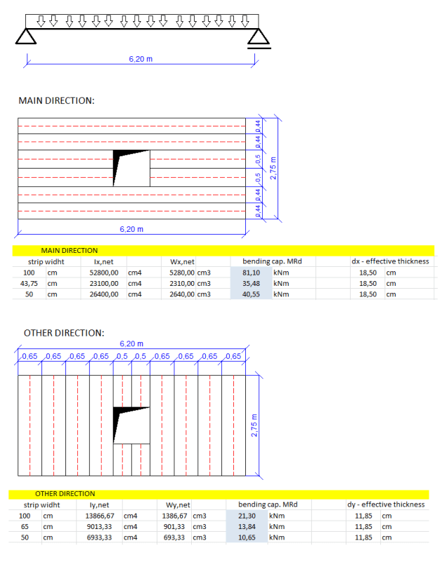

I'm designing a CLT roof - span in main direction is 6,20 m.
CLT slab is 200 mm thick and it has opening in the middle of the span 1,0 x 1,0 m.

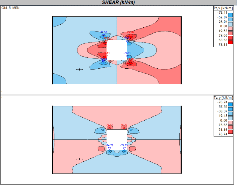

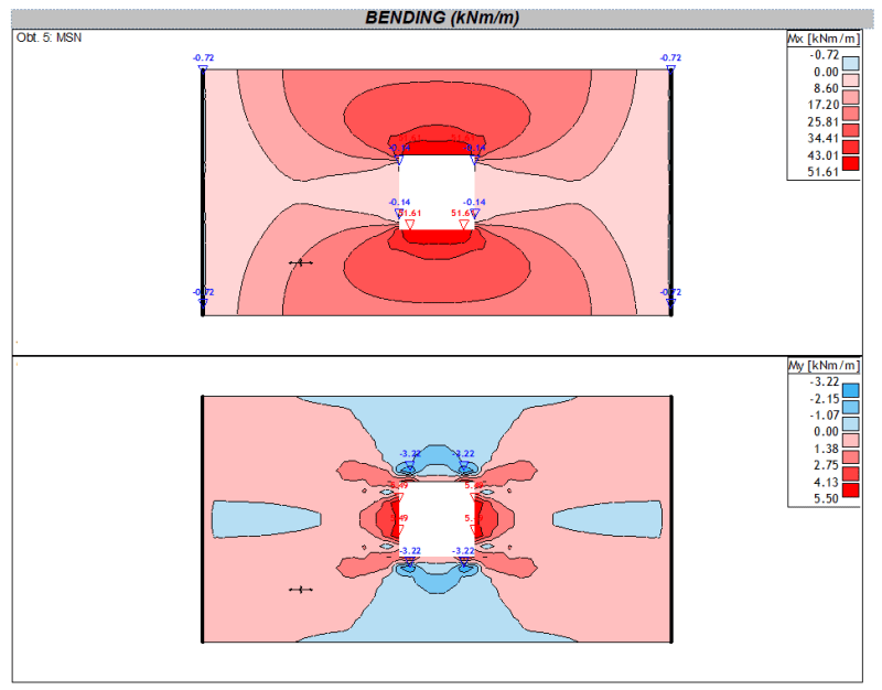

I made FEM analysis and the strip model analysis. I figured that the bending capacity is OK but
I don't know how to approach huge spike of stresses at the edges of the opening?
Would you reinforce them? What do you suggest (steel angles?) and how to calculate it?
Thank you for reply.

Do the stresses around the opening exceed the allowable stresses or are they just too high for your comfort level?
If they do not exceed allowable stresses, I'd leave it alone. Otherwise, I may look at adding some flat steel bars or angles below to assist with load sharing.
No FEA needed, just consider the steel acting as a beam and transferring the reactions to the adjacent panel strips.
Also, if you tighten your mesh, how does that affect the concentrations you're seeing. If the tighter mesh causes tighter areas of concentrations, then it could be a modelling anomaly rather than a real life issue.

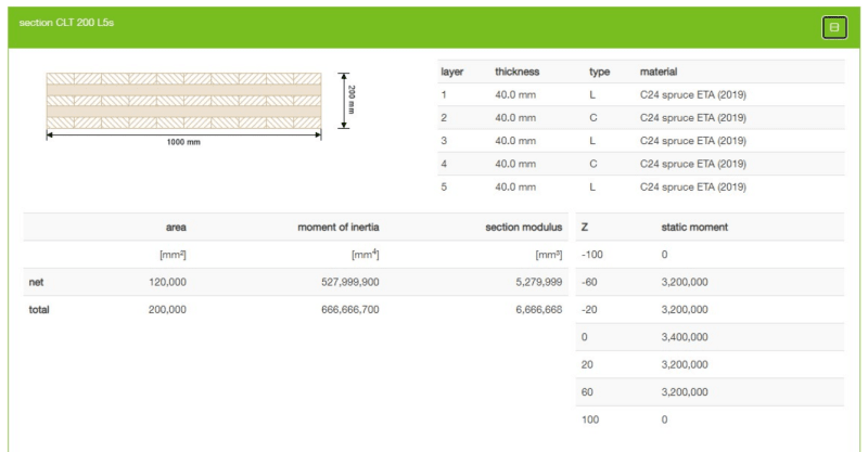

Is it appropriate to model a CLT floor like that? I know there is load sharing between adjacent panels, but is it that robust that it truly behaves as a monolithic slab?
Are you doing two layers of CLT panels, or are you trying to look at each layer of a single panel?
TO be fair, his 2.75m wide panel would potentially be a single panel. The ones I had on my project ranged from 2m to 3m wide. Essentially as long as it's shippable they can build them. So he may be trying to approximate the orthagonal layers.
Got it. I guess that's just a hair over 9ft. Doable with oversized permits here. If that's the case, I'd probably leave the internal performance of the panel up to the manufacturer.

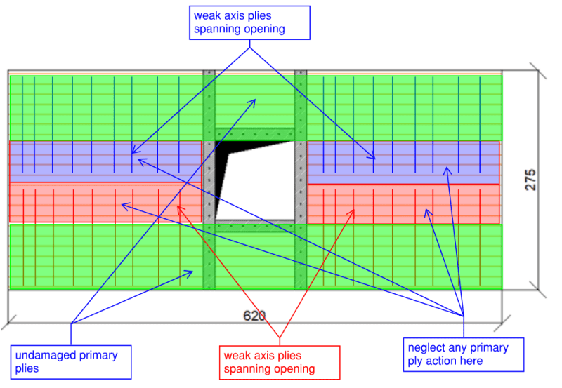

I'd be surprised if a single plank worked for this size opening upon further examination unless the panel thickness is drastically oversized for strength elsewhere. Potentially if the opening was split in half for two planks, there's a possibility it works out, but there is no moment capacity across the joint between planks. So that would need to be treated as a pin connection with the capacity of the joint kept in mind for load transfer. I'd likely be ignoring out of plane shear transfer as well and just look at the weak axis plies cantilevering to pick up the areas affected by the opening.
Essentially I'd be looking at the remaining unaffected width of the panels as the only effective portions of the panels for overall load support. The areas affected by the opening would just be transferring their regular design loads back to the un-cut primary plies.

I don't have an issue with bending.
If there was no opening the bearing capacity of the slab is around 50%.
I'm not really fond of high shear stresses at edges of the opening since I'm not really sure how to consider them for design...

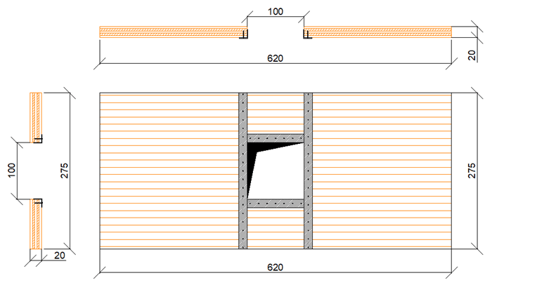

What do you think about reinforcing it with steel angles (150 x 150 x 10 mm)?
I'd likely be doing what KootK indicated with just a bunch of inclined screws to reinforce the corners. But you're the one that needs to be confident in the design. I don't see what the two angles running left right are doing for you? Also, to run your angles past the opening either requires you to remove the flange of the angle (then what was the point of using an angle section) or cutting a flange slot in the entire panel (to what benefit?).
I'd be looking at the weak axis bending capacity of the panel to span the opening. Like the attached sketch. And if you're worried about the primary plies peeling from the bottom of the panel at the corner of the opening, I'd be looking at some inclined screws to tie the bottom ply to the upper plies.
I totally misunderstood the direction of span here. Would your transverse reinforcing not interrupt your primary bending capacity? I feel as though your in pretty good shape here without the reinforcing. I imagine you are governed by rolling shear?
If the span were the other direction, I'd be even less concerned.
