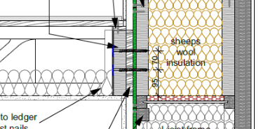

Apologies for any terminology errors here and I am in the UK so it may differ from the US but the attached diagram should help. I am looking to justify the capacity of screws through a 45mm thick LVL ledger beam (supporting floor joists) to a rim beam spaced apart by 12mm OSB and 25mm battens. I can't find any references for doing this. One reference just said that screws should not be used in multiple shear plane applications - so does that make this detail impossible?
 https://files.engineering.com/getfile.aspx?folder=dffc25ff-ea31-46d4-98ca-1f0de665b5f4&file=Screenshot_2023-03-31_105702.png
Here is another detail I meant to add
What are the battens doing? I'm afraid your detail isn't quite clear. The OSB doesn't worry me, but something in the small screenshot isn't adding up. Why does it look like you have an I-joist, but in weak axis orientation (assuming this is a section view of the floor to wall connection).
The battens are 50x25mm vertical counterbattens at the vertical stud locations to allow for a service void inside the OSB airtight layer. Then the LVL ledger beam is fixed through both of those into the inner LVL rim beam. There are metal web I joists. Below is a 3D cutaway view without the OSB and counterbattens
So realistically the screw itself never has to span a gap? It's solid wood all the way from head to tip? In that's the case, I'd likely be providing the proper embedment into the final intended bearing layer and otherwise ignore the rest as just a thicker rimboard. This assumes the battens and OSB are nominally fastened to the substructure.
There are no gaps and the screws will be 6mmx140mm Heco Topix screws which have a thread that draws the members together. I was hoping I could treat it all as a thicker rim board but I was given pause for thought by a Eurocode 5 timber design textbook that said screws were not suitable for connections with multiple shear planes.

As jayrod mentioned, the battens and OSB must be nominally fastened to the substructure. In other words, they are already behaving as a single member due to fastening elsewhere. If these screws are the only things holding the batten to the OSB and the OSB to the substructure, then you're concerns would be valid and it wouldn't work.
Thanks phamENG. The OSB is certainly fixed to the substructure at 300mm centres and the vertical battens are also fixed through the OSB to the substructure again at 300mm centres (in between) but does that mean I need to check the ledger beam capacity as if it was just connected to the batten, then the batten as if it is just connected to the osb and then the osb to the rim beam? I am not sure that would work.
No, since the battens and OSB are nominally fastened on their own, i.e. the screw doesn't need to carry their weights/loads as well, then I wouldn't concern myself with them, I would just ensure that the appropriate embedment in the wall studs is provided for whatever load you need.

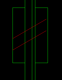

Another thought I have had is to use an inclined screw connection such as this and design using the truss model which has the advantage of not relying on dowel action at all - see below.
If those battens are discrete and not continuous parallel to the ledger, then there is a risk of degradation/cracking over time (and maybe on install) thus softening the entire joint. From aerospace experience, screws/bolts do not perform well in bending, such as when there is a large shim stack in the joint, similar to this situation. If you can’t eliminate the battens, I would make the battens wider, and attach them to the rim beam with columns of screws on either side of the joists. And increase the size of the screws attaching the joists.

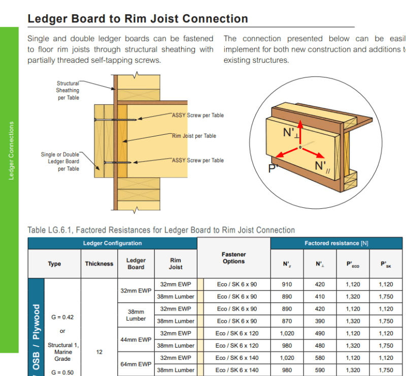

I happened to come across this from the MyTiCon connections design guide which is similar to my situation but without the additional battens so they have worked out some capacities for 90 deg connections through OSB although it can only make it better to have the connections angled.
