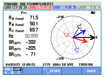

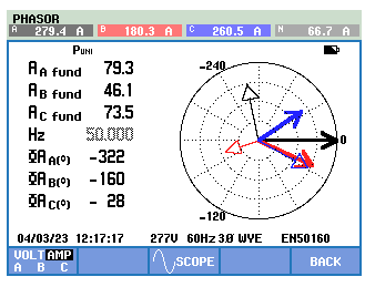

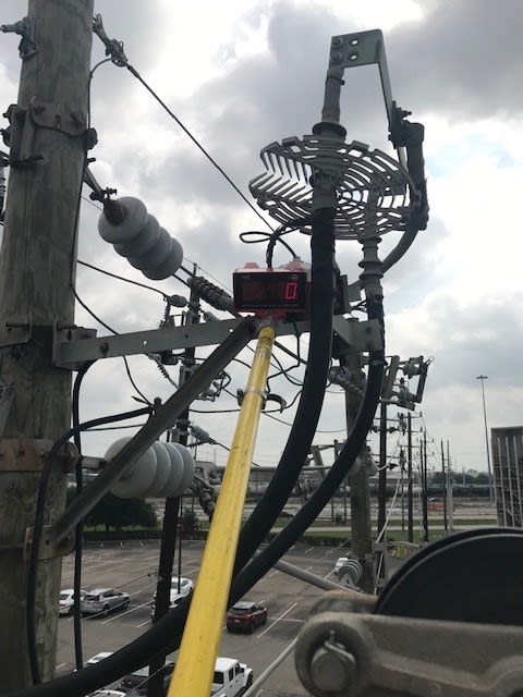

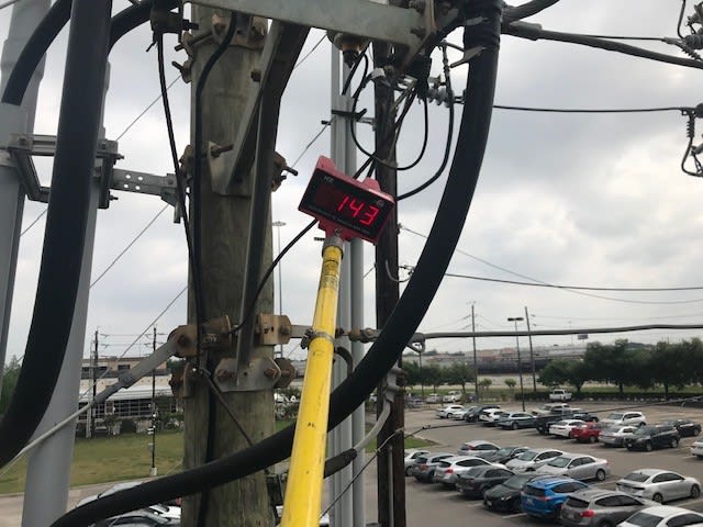

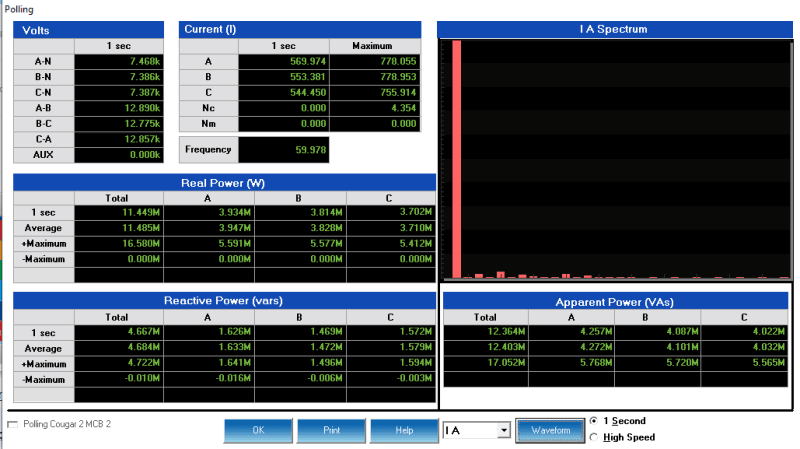

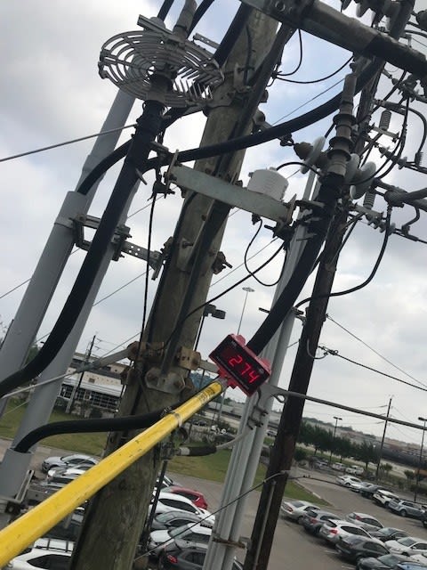

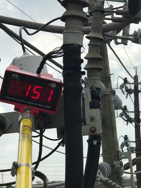

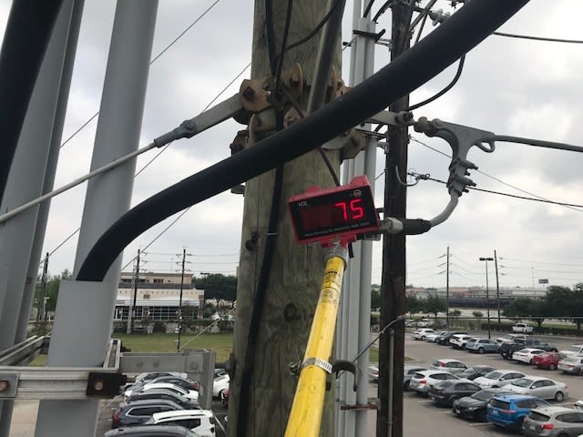

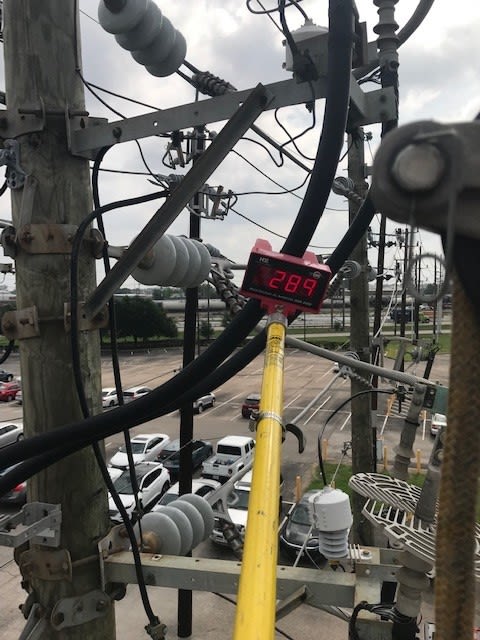

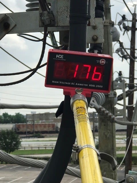

I work at a large University in Texas. When the electrical deregulation happened here the utility built us our own 138kv/12,470kv substation. Ever since we have had issues with our concentric neutrals burning up on our pole tops and splices burn up in our manholes every few years.

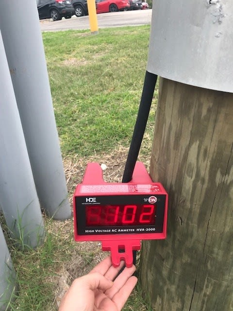

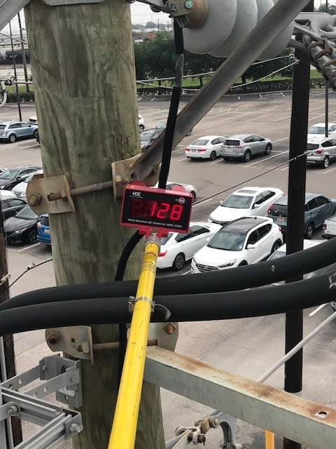

Although my SEL relays only show about 25amps of neutral current, I have measured 200 amps on the pole top jumpers between the concentric neutrals on the cable to the main neutral cable. See attached pictures for examples of the very strange readings.
I recently walked the line and noticed there are still some interconnections between our circuit's neutrals and the utility company (Center Point) city circuits that all originally came from the utility substation that these circuits used to originate in. Could this cause circulating neutral current at these levels?

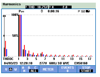

The SEL relay also does not show excessive harmonics.
These are our main feeders from our substation Delta/Wye 138/12 KV transformer to our main gear on campus which connects to a ring bus. Entire run is about 1.1 miles from Sub to Central Plant. Some underground, some overhead.
We have 3 circuits, 2 of which feed a Main tie Main gear. 1 of which normally only feeds our Central Plant. The 2 that go to the main tie main gear each break out into 8 sub feeders which power our campus buildings. The Sub feeder cables do not have concentric neutrals tape shield only.
I should also mention that our incoming Main Feeders have a Nexus 1500+ power quality meter and although they do not have neutral CT's installed the meters do not show any calculated neutral current. But if I put an amp probe on the concentric neutrals at the back of the gear i can read up to 200 amps.
Anyone ever see this before? Any ideas?
URL]
URL]

I think you are on to something with possible circulating currents from the utility neutrals. I'd inspect the utility neutrals to see if there is an open point somewhere that is forcing utility neutral current to flow through two points on your neutral. This could be severe during a utility ground fault, causing thousands of amps of fault current to flow through your concentric neutrals.
Thanks for all the replies. I will attempt to address all the questions below:
wcaseyharman said:
One technique we tried to use was to determine the phase angle of the neutral current relative to say phase A to see if we could rule anything out by the phase of the current.
I would also look at the transformer configurations and make sure your neutrals aren’t providing a path for other ground sources. You also might ask the utility if they have unbalanced feeders.

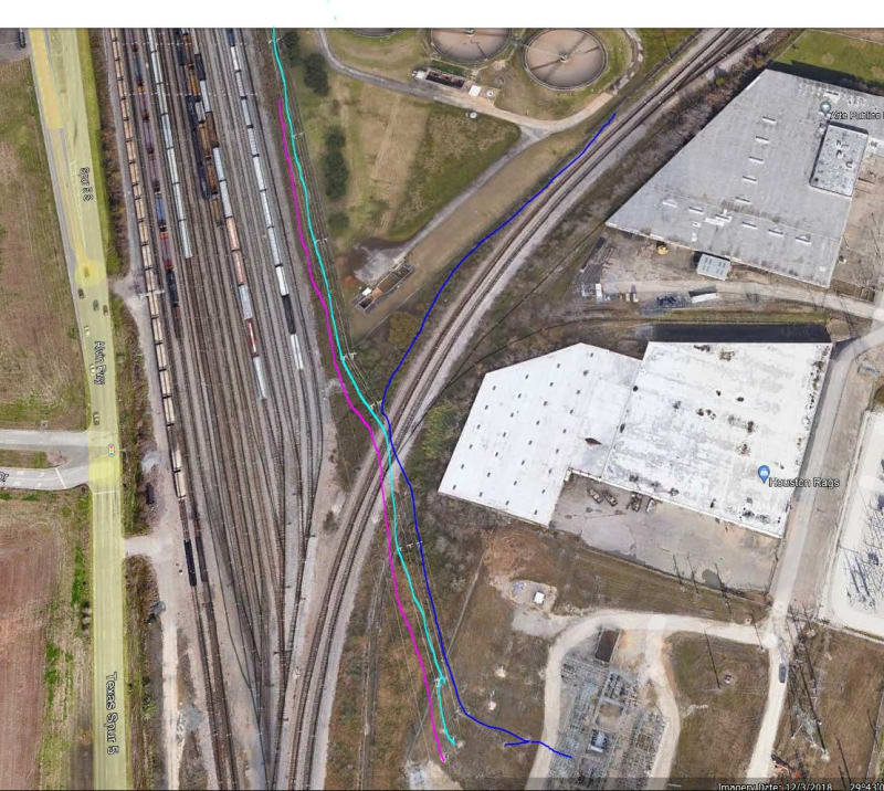

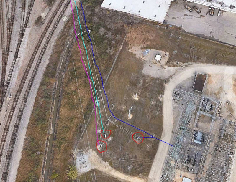

No sure what you mean by " Path for other ground sources." Our substation transformers (2-33 MVA) are 138kv Delta to 12.470KV Wye.
They leave our substation underground to the Utility substation that the circuits used to originate from before our sub was built.
Then it transitions to overhead for about 1/2 mile.
Then it goes underground again for about 7,000 ft.
Transitions to overhead again for about 300-400 ft.
Transitions to underground for the remaining 1100 ft to the back of our gear.
Cable is parallel 1,000 MCM with 1/3 concentric neutrals. All concentric neutrals are bonded in each manhole and on overhead.

waross said:
Are you seeing a corresponding ground current anywhere? Not much, a few amps at most as measured by the SEL relay.
Are the concentric neutrals grounded at both ends? Yes, and at each manhole and terminal pole.
You may have induced EMF in the concentric neutrals which is shorted out by grounding at both ends. I know we do have some issues with induction due to the way the Utility originally ran part of the underground. Instead of ABC in one conduit for each parallel run they ran 2 A's and a B or 2 C's and a A. Really strange stuff. We have corrected one of the 3 runs. Are you saying that the concentric should NOT be bonded at all points?
Even a relatively low induced voltage in a sheath or concentric neutral will drive a relatively heavy current through a closed loop. So, are you suggestion disconnecting the ground connection at one end?

I think you are on to something with possible circulating currents from the utility neutrals. I'd inspect the utility neutrals to see if there is an open point somewhere that is forcing utility neutral current to flow through two points on your neutral. This could be severe during a utility ground fault, causing thousands of amps of fault current to flow through your concentric neutrals. Yeah, I wish it was easier to explain the strange connections I have seen.

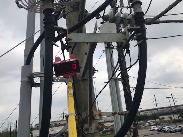

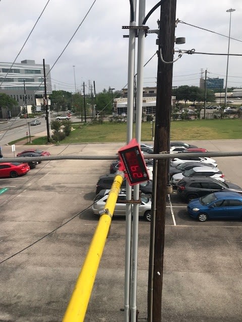

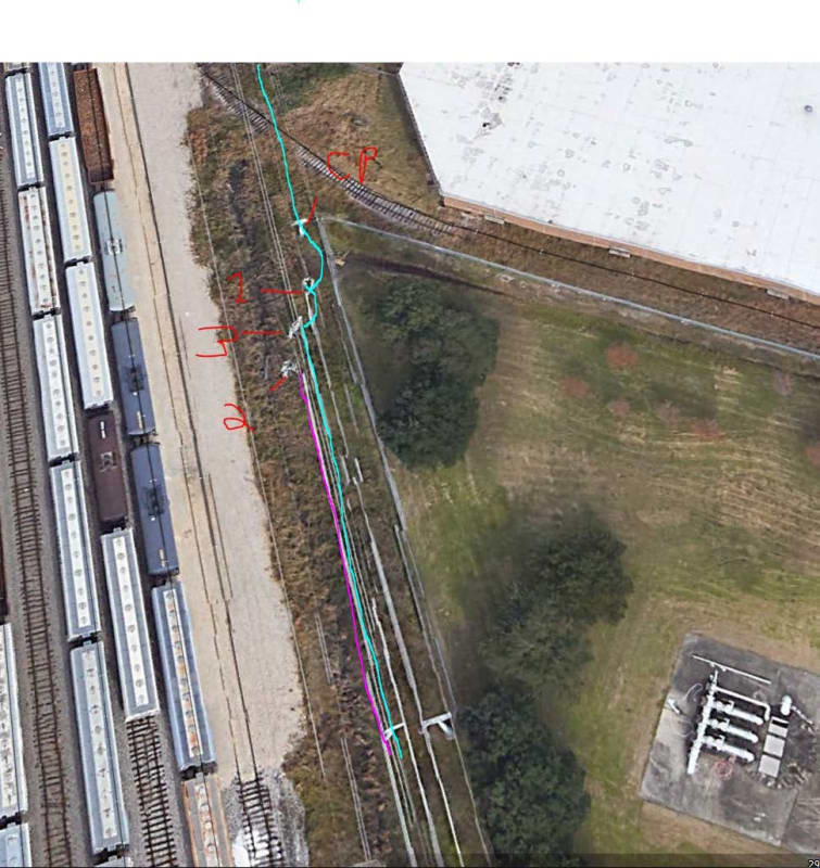

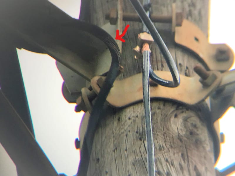

See below pictures for how the Neutrals are connected on CGR 1,CGR2 and CGR 3. Each different color is a different neutral conductor. CGR 2 is the reddish line. Aqua line is CGR 3. Dark Blue is a CenterPoint circuit.
The terminal pole in the CP yard is tied to a neutral on a CP circuit.
The CGR 1 neutral at terminal pole by the railroad is tied to the CGR 3 Neutral and also jumps to a different CP circuit and continues down the line.
So, the pics in the original post were on circuit CGR1. That is the circuit that had a splice failure again on 3-15-23, so all building loads have been on circuit CGR2. The following pics are form readings this morning.
A concentric neutral on a single conductor cable will mimic a shield.
It is common practice to ground shields at only one end.
You may be able ti greatly reduce or eliminate the unwanted current by transposing the concentric neutrals.
At each transposition, the load end of the A phase neutral is cross connected to the feed end of the B phase neutrl.
Then B to C and C to A.
Each neutral should spend an equal distance with each phase, or as near to equal as possible.
The neutrals must be isolated from each other and from ground at each transition.
That will allow the induced voltages to cancel out and with the induced voltages cancelled, there will be no induced current.
As for ground currents:
1. That is too much ground current to be reasonable.
2. You have a textbook case for circulating currents from induced shield voltages.

You may be able to greatly reduce or eliminate the unwanted current by transposing the concentric neutrals.
At each transposition, the load end of the A phase neutral is cross connected to the feed end of the B phase neutral.
There are multiple transitions from underground to overhead and back again. The overhead only has a single neutral to connect to. So, on a terminal pole there isn't a separate Feed/Load concentric. (Overhead is single 2000MCM phase conductors whereas the underground is Parrell 1000 MCM) What would the overhead static ground/grounded side of surge arrestors/terminal pole ground, connect to? The Concentrics are also bonded to the manhole grounds in each MH. Are you saying all these should be disconnected?

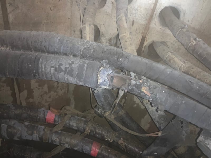

1. That is too much ground current to be reasonable. Agreed, we have had many splices blow up at the concentric snap ring and melted insulation from the jumper wires to prove that.
2. You have a textbook case for circulating currents from induced shield voltages. I don't disagree, but is there a possible solution other than a complete redesign of the existing system?

Step one:
Interrupt the current.
At every access point, the concentric conductors should be grounded on the outgoing cables and insulated on the incoming cables.
A concentric wrap on a multi conductor cable may be a concentric neutral.
A concentric wrap on a single conductor cable is an equipment grounding conductor.
The concentric wrap may only be used to ground equipment that does not have the neutral bonded to the equipment.
When the concentric conductors are not used or can not be used for equipment grounding they should be treated as a shield and grounded at the feed end and isolated/insulated at the load end.
It is good practice and safer to treat each individual section independently and ground and isolate at each manhole or transition.
Step two:
Provide a neutral.
Is a neutral needed?
If all of your loads are line to line, you may not need a neutral.
If you do need a neutral there are several possibilities;
a) Run neutral cables with the phase cables. In some instances this is the easiest solution, but in your case this may be the most difficult and expensive.
b) Install an artificial neutral. This may be a zig-zag transformer or a small wye delta bank.
The zig-zag may be a special order. You may be able to use distribution transformers in wye/delta connection to develop an artificial neutral.
The size of the artificial neutral should be the greater of;
i) Adequate to carry the greatest possible neutral load current.
ii) Adequate to withstand fault current until the protection clears. This may be mitigeted by resistance grounding.
c) install a ground grid including consideration of a buried conductor encircling the buildings that are fed from the circuit.
This should be about three feet from the outer walls.
My first choice would be option b), artificial neutrals.
Note. Some literature designates the concentric conductors as a concentric neutral. Some literature designates the same construction as an equipment grounding conductor.
In the instances where the literature calls the concentric conductors a concentric neutral; Do you believe everything that a salesman tells you?

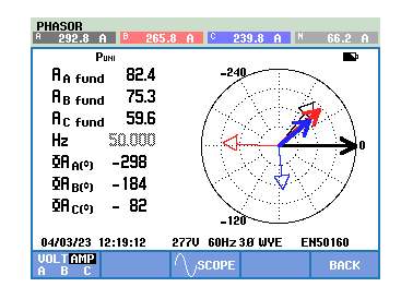

I had trouble interpreting the phaser plots, it’s wasn’t clear to me which label was associated with each phaser.

RonUH,
There is a lot of information in your posts and it would be really helpful if you could possibly insert the details onto a schematic which includes the neutral grounding locations and any ring arrangements. It might provide a better presentation to allow the problem to be assessed more thoroughly.
Like wcasey, I’m also having difficulty reconciling your phasor plots. The real and reactive power values seem reasonably balanced between phases. The phasor values are less clear however.
1. Are the "open triangle" arrowhead phasors displaying current magnitude and angle? They are close to 120 degrees apart but with some variability.
2. What are the "line" arrowhead phasors showing? – They are certainly not 120 degrees apart
Finally, the site is adjacent to rail tracks and although I cannot see traction power structures in the images, there does look like a line above the right most track. Is there any chance that there is traction power in the area? If so, it might be worth considering whether traction return currents could be carried in your neutrals.
