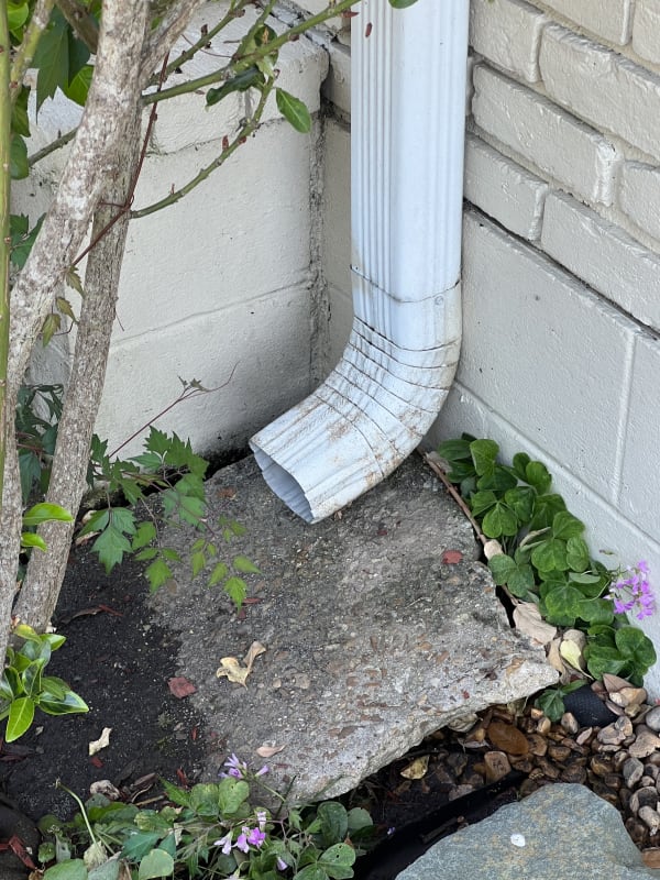

ETA: The crack and leak is directly beneath the downspout area. It's clear that runoff has "eroded" a bit of soil (despite the concrete block), and made it's what through a crack in the wall.

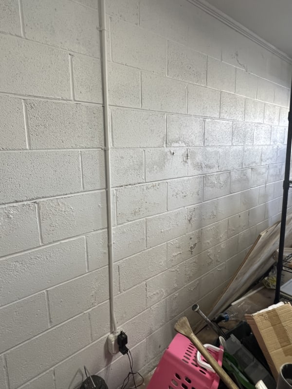

Also, this is a picture of inside the garage. This is the exterior, load bearing wall, that is a continuation of the retaining wall.
Does the “bubbly” paint look like evidence of efflorescence? Those areas were certainly powdery to the touch.
I'd imagine the hole can still be plugged with a water-stop cement to at least prevent leaking.
That's moisture pushing the paint off. Again, if you can't get to the back side, you will have to live with it. Patching will not make a wall water tight, but it might stop running water.
The first thing to do is to move the downspout to the other end of the house. Yes requires resloping the gutters, but its not that hard. And if that location is not well sloped away from the house, then reslope or add a swale to get the water away from the foundation.
