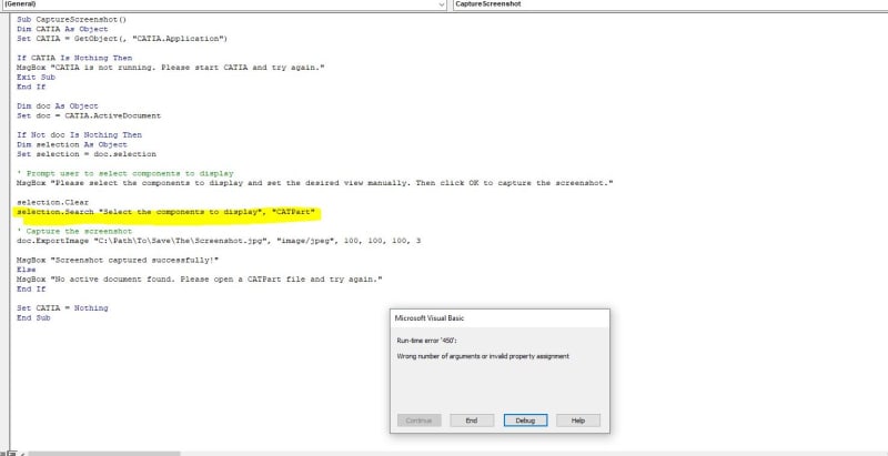

Hi Everyone,
Let say I have four components in the CATPart File.
I need to take screen shot automatically with White background, The view should user need to rotate manually.
Parts:
A
B
C
D
If Macro, ask for the components to display , I will choose B & C then click for camera , I need set the view manually , once I click okay will need to take screen shot.
Try this:
Code:
Sub CaptureScreenshot()
Dim CATIA As Object
Set CATIA = GetObject(, "CATIA.Application")
If CATIA Is Nothing Then
MsgBox "CATIA is not running. Please start CATIA and try again."
Exit Sub
End If
Dim doc As Object
Set doc = CATIA.ActiveDocument
If Not doc Is Nothing Then
Dim selection As Object
Set selection = doc.Selection
' Prompt user to select components to display
MsgBox "Please select the components to display and set the desired view manually. Then click OK to capture the screenshot."
selection.Clear
selection.Search "Select the components to display", "CATPart"
' Capture the screenshot
doc.ExportImage "C:\Path\To\Save\The\Screenshot.jpg", "image/jpeg", 100, 100, 100, 3
MsgBox "Screenshot captured successfully!"
Else
MsgBox "No active document found. Please open a CATPart file and try again."
End If
Set CATIA = Nothing
End Sub
Modify the file path in the line doc.ExportImage "C:\Path\To\Save\The\Screenshot.jpg", "image/jpeg", 100, 100, 100, 3 to specify the location where you want to save the screenshot.
i'm getting error on the yellow line
i'm using CATIA V5
Sorry I can't test it right now.
Try this:
Code:
Sub CaptureViewport(strFileName As String, Optional intWidth As Integer = 1024, Optional intHeight As Integer = 1024)
    Dim objWindow As SpecsAndGeomWindow
    Dim objViewer As Variant ' Viewer3D
    Dim objCamera As Camera3D
    Dim objViewpoint As Variant ' Viewpoint3D
    Dim arrOldBackgroundColor(2) As Variant
    Dim intOldRenderingMode As CatRenderingMode
    Dim intOldLayout As CatSpecsAndGeomWindowLayout
    Set objWindow = CATIA.ActiveWindow
    Set objCamera = CATIA.ActiveDocument.Cameras.Item(1)
    Set objViewer = objWindow.ActiveViewer
    Set objViewpoint = objViewer.Viewpoint3D
    objViewer.GetBackgroundColor arrOldBackgroundColor
    intOldRenderingMode = objViewer.RenderingMode
    intOldLayout = objWindow.Layout
    ' This might be extended to record the old window dimensions as well
    objViewer.FullScreen = False
    objViewer.PutBackgroundColor Array(1, 1, 1) ' White
    objViewer.RenderingMode = catRenderShadingWithEdges
    objWindow.Layout = catWindowGeomOnly
    objWindow.Width = intWidth
    objWindow.Height = intHeight
    objViewpoint.PutSightDirection Array(-1, -1, -1) ' Isometric
    objViewpoint.PutUpDirection Array(0, 0, 1)
    objViewpoint.ProjectionMode = catProjectionCylindric ' Parallel projection
    objViewer.Reframe
    ' Without this, the picture is not always sized correctly
    CATIA.RefreshDisplay = True
    objViewer.Update
    objViewer.CaptureToFile catCaptureFormatBMP, strFileName
    CATIA.RefreshDisplay = False
    objViewer.PutBackgroundColor arrOldBackgroundColor
    objViewer.RenderingMode = intOldRenderingMode
    objWindow.Layout = intOldLayout
    ' This might be extended to restore the old window dimensions as well
End Sub
or try the free vba app available online called TAKE_PIC.
