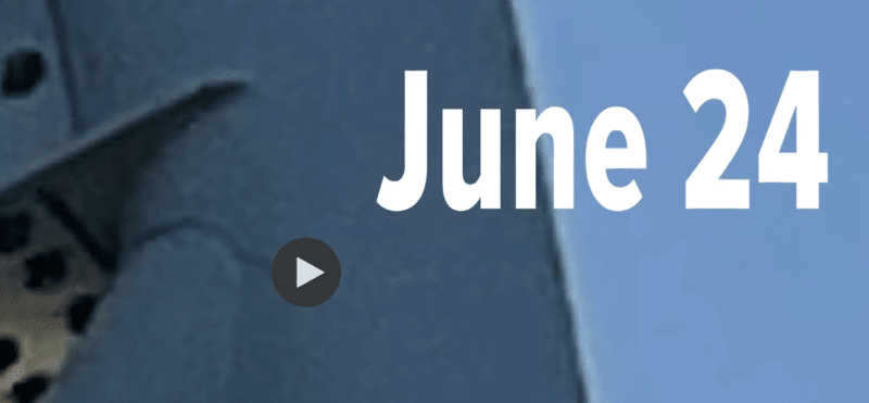

The left half of the crack is through a weld, the right half propagated through the pipe. I don't see much corrosion staining which means it's either a very dry climate or the crack propagated very quickly. I'm going to guess a weld quality issue here as that would support my rapid propagation observation.

This is not just a fair ride. It is a major rollercoaster by any definition. There is lot going on in that weldment, and the corner stress riser, in hindsight on my part of course, was suspect. The operation of the coaster has formed a pin by failing a weld. Perhaps there should have been a pin there in the design.
I'm "impressed" (probably a poor word choice) that the coaster still performed so well after complete loss of one of the supports. The box beam track section must have considerable factor of safety that it can span between the 2 adjacent supports under full service load after being completely disconnected from the broken support. Of course there is no telling how many cycles of that load it could have withstood before a catastrophic failure of the box beam track section or one of the other supports.

This news piece shows a photo taken on June 24 clearly showing the crack starting.
Visible to a member of the public, with no special training, from far away.
The daily inspections missed it for at least a week.
This is what is called objective evidence that the park's inspections are inadequate.
