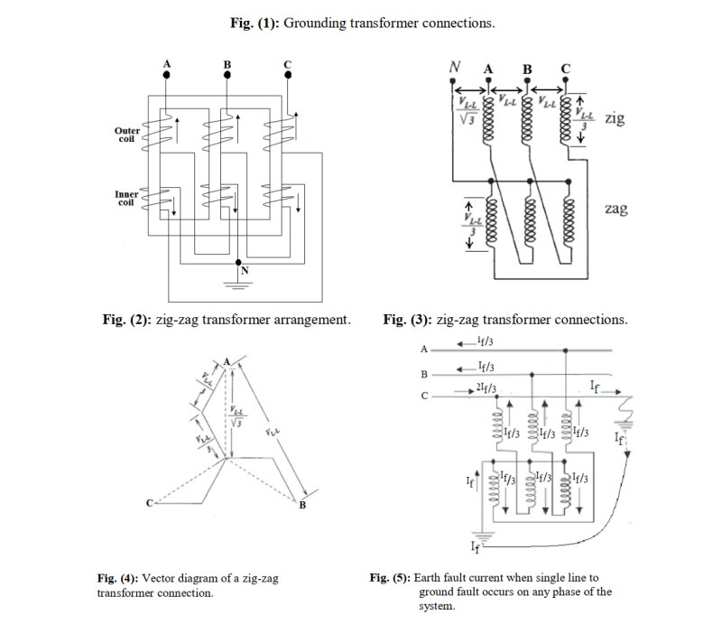

Hello fellow engineers,
I'm currently working on a wind farm generator setup where we have an earthing transformer with a capacity of 1000kVA connected to a busbar operating at a voltage level of 35kV. The Neutral Earthing Resistor (NER) has a resistance of 50.5 ohms. My objective is to determine the appropriate CT (current transformer) ratio for accurate and safe measurement and protect the bay of earthing transformer of short circuit currents in this system.

Hi cranky108,
Thank you for your responce.
Transformer impedance is 50.5 ohm, CT rating: secondary rating in our country used 1 amp and its working principle is the same with 5 amp. When a single phase short circuit fault happens, the short circuit current in the 35kV busbar is 1400 amps, after the earthing transformer resistor, it will be 225 amps per phase. The function of earthing transformer is to reduce single phase short circuit current and to create neutral connection for 64REF relay, because in 35kV system has no neutral connection because of star delta connection step up transformer. I have attached here Earthing trasnformer drawings.
Ramzat - ideally, the current transformer does not saturate at the highest possible current it will see, AND it will have enough resolution for the monitoring equipment to accurately represent the current observed. What this means is that a CT intended to measure line current needs to have enough ratio that the "high" side is more than the line current (typically around 10-20%) and the "low" side fit the full-scale rating of your monitoring system (in your case, 1 amp). If the CT is intended for fault protection, it has to be capable of not saturating under fault current conditions - which are MUCH higher than normal running current conditions.
If the CT is measuring current AFTER the neutral resistor (where the current is limited to 225 A/phase), then it needs to be at least 225 A ... next "standard" rating would be suitable (i.e., 250 or 300 or whatever). But it should also result in 225 being at or near full scale on your monitor (i.e., not 1000 or 1200 or something) so that you have a noticeable "swing" between fault and no-fault conditions. Don't want the fault signal to get lost in the "noise" band of the sensor!
If the CT is BEFORE the earthing resistor, it has to be enough to handle 1400 A without saturation (next "standard" rating is 1500 or 2000). Same thing applies to low side regarding "noise".

A CT on the neutral will see exactly the same current regardless of which side of NER it is on. Current in the circuit is the current in the circuit regardless of where in the circuit.
David - you are correct. No idea what I was thinking (except that I was multi-tasking at the time and may have stopped halfway through and not re-read my starting train of thought).
