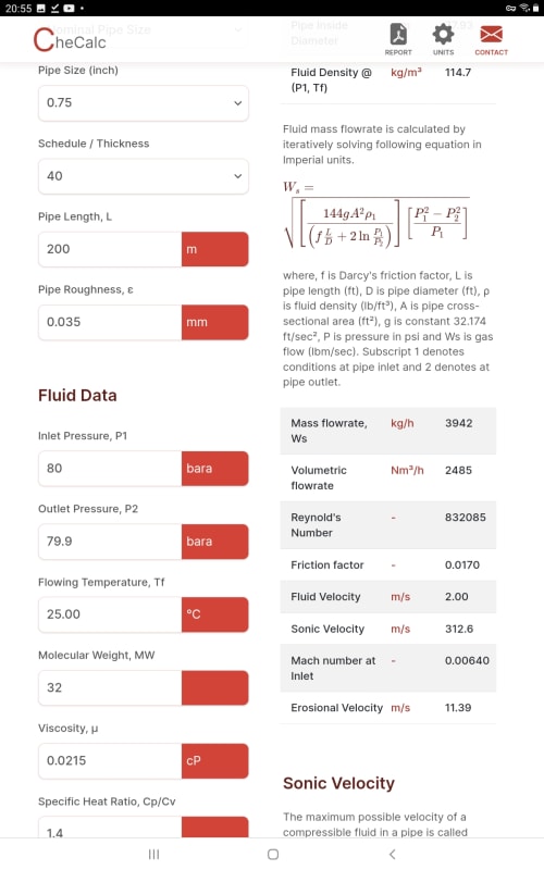

Found a ...reputable... site (Chemical Engineering Calcs, "Che Calc") with an Isothermal flow calculator, verified my variables, and after half a dozen runs got to a number.
I have attached my final run.
I was initially getting a calculated value for density of 352 kg/m^3; which seemed odd, as my calculated value was about 115 kg/m^3 at 1300 psi. See upper right of attachment. Seems I had a value of Z (compressibility) of 0.308, which I found on a website. A couple other websites defined Z (at 1400 psi) at 0.95-0.97; including one from the National Bureau of Standards, circa 1947! That seems to have solved the problem.
This meets my requirement to provide a nominal 0.7 kg/sec (2500 kg/hr), with a resulting dp of 221 psi; which seems (not coincidentally, I hope) to closely match the value provided by georgeverghese.

I tried your che calculator using closely matching data as I could .z=0.9
I used 10m length.
As you can see i used a pressure drop 0.1B
And I got a flow 5X what you need.
I could have 200m length and still get 2500 m3/h flow. See 2nd run.
