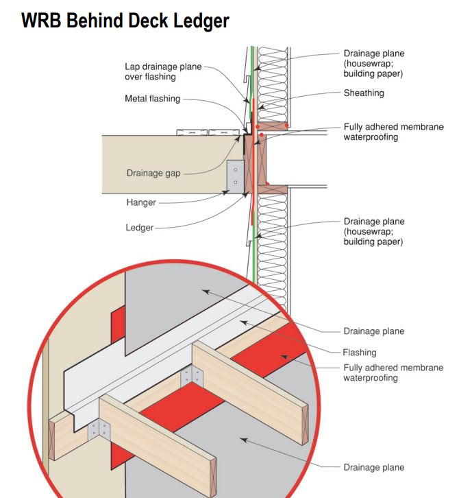

These days we like to integrate the ledger into the drainage plane. You (or architect) should specify the tie-in behind the ledger - adhered membrane such as Blueskin SA - and above the ledger (e.g. bent metal flashing or Blueskin VP if concealed). See here and here. Same principal for a concrete wall as it is a wood stud wall.
From a waterproofing standpoint for a wood framed wall, that detail seems alright. Structurally, though, I wouldn't want the load transfer from the joist so close to the bottom of the ledger.
For a concrete wall, I'm not sure this is necessary, but curious to see what others do.
