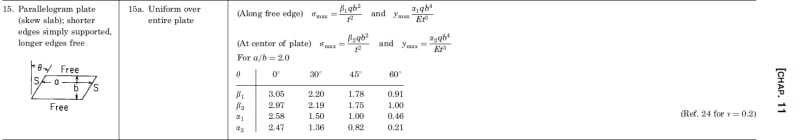

Hello everyone,
I am seeking assistance in finding formulas to calculate the stress and deflection of a flat, rectangular plate. The plate is simply supported along its long edges and free on the short edges, as illustrated in the attached figure.
I have explored resources such as Roark's and Timoshenko, but unfortunately, I have not been able to locate relevant information.
I appreciate any help you can provide.

I appreciate your comments. here is additional details that I inadvertently omitted:
Plate Thickness: The plate has a thickness of 2mm.
Material: The plate is constructed from stainless steel.
Load Distribution: The load is uniformly distributed across the plate.
Dimensions: The width (b) of the plate is 550mm, and the length (a) is 1500mm.

The cross-section of this configuration, looking along the axis of the long direction, would be a equivalent to a 'Simple Beam with a Uniformly Distributed Load'. The length (dim 'a') only comes into play when computing the Moment of Inertia (I). Once you've calculated that (which is why we need to know how thick the plate is), all you need to know is the total weight of the plate and the Modulus of Elasticity (E) (Young's Modulus) of the material, you should have all you need to calculate the maximum deflection and maximum stress.

Does this help? for angle = 0?
I found this example in Roark's but in this case, the shorter edges are simply supported.
I'm curious if this scenario is more conservative than mine
I think there’s a part in Roark that shows you how to modify beam bending by introducing Poisson’s ratio effect. The free edges do deflect differently to the main section, down to the fact that there is no distributed shear or moment along the edges.
Roark Seventh Ed. said:
11.10 Bending of Uniform-Thickness Plates with Straight Boundaries
Formulas. No general expression for deflection as a function of position in a plate is given since solutions for plates with straight boundaries are generally obtained numerically for specific ratios of plate dimensions, load location, and boundary conditions.
The sub-section titled "Bimetallic Plates" (11.4 in the Seventh Ed.) presents a method that might simplify to your case.

IdanPV, Your error is in your problem statement. You don't have a "plate". You have a simply supported beam of "b" length, "a" width, and thickness of 2mm.
