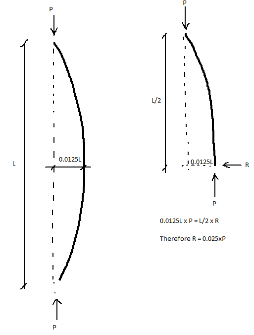

The 2.5% is the force required to resolve the lateral component of the axial force based on an assumed out-of-straightness of 1.25% of L (I think...).
In theory, a perfectly straight column requires zero force in the restraint to prevent it from buckling.
...wouldn't 1.25% out-of-straightness just be 1.25% lateral force?
Why yes, I do in fact have no idea what I'm talking about
Some codes use 2.5%. Others 2%. It's not an exact science. It depends on various assumptions, E.g. following from bugbus's comment, a crooked column will need more bracing restraint than a perfect column.
Yes but you can have that above and below the point of restraint, so it doubles.
But again, these are all quite crude assumptions.
This is how I remember it when I last saw this in a textbook, but I might be missing something

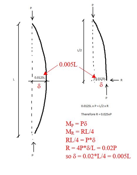

@bugbus,
Correct me if I'm wrong, but shouldn't the moment from R be RL/4? If so, the assumed out-of-straightness would be 0.5%, not 1.25%.
