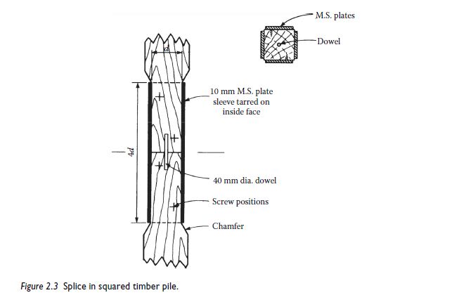

8x8 timber piles will be embedded about 14' into the ground. The design called for them to be continuous up to a second level deck, but for valid-ish reasons they can't get piles that long installed. Splice would be located a few feet off the ground. Given the embedment, I'm thinking we it can be modeled as fixed pinned with a hinge in the middle and be made to work...but I don't love it. Maybe a pair of L7x7s on opposing corners and through bolted...
A few of these take lateral load, but given the height it's delivered through in plane braces and I can coordinate the reaction to get it directly into the embedded pile.
Anyone see a reason why this absolutely shouldn't be done? Kind of a touchy situation and not one that can be left to sit for more than about an hour...

I'm fine with this in general for axial and a little shear. If there's no tension, you could convince me to even use a dowel pin the center of the pile. With tension, I suppose you could use one of those dowels things with cross pins. It doesn't sound as though you've got time to procure something like that though. A pair of L7 works for me too. The setup feels a bit like how we splice multistory steel columns.

Thanks for the reassurance. I was thinking of a combined drift pin and angle solution, but the bolts aren't playing nice with the drift pin...may just have to forgo that. I've heard rumors of a similar solution published in an old Air Force construction manual, but haven't seen the source.

I would consider connection with sleeve (RHS) . The pile tips are inserted and
bolted ..
The following snap from TOMLINSON , Pile Design and Construction Practice..

HTURKAK - that's similar to what I was going to do with the angles. Drift pin with steel angles all around. Thanks for posting the picture.
