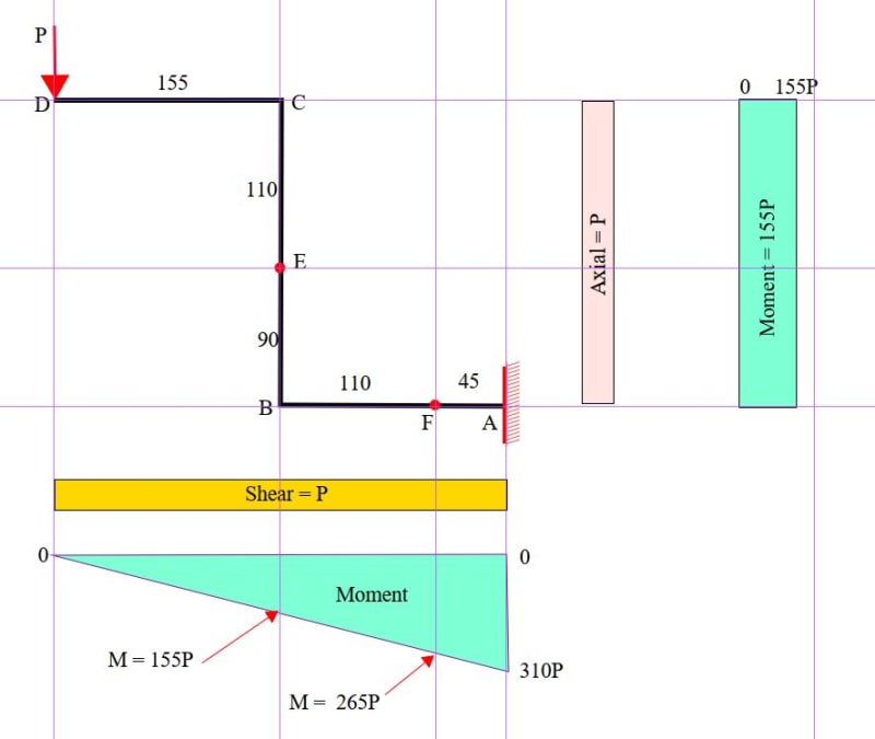

I don't know much about strain gauges, but below is a sketch showing axial and shear load as well as bending moments. Strain gauge locations are named E and F. Dimensions edited in accordance with rb1957 post following.
There will be some lateral deflection when load P is applied. That will change the geometry a little, but it is probably safe to ignore it for now.
isn't the offset 150mm to the edge of the 10mm wide tube ? so the offset to the axis of the tube is 155mm ... no?
is the area of the vertical 81mm2 or 89mm2 (typo in reply ??)
Ok i get it, the rosette reads the deformation on the axis of vertical tube, so the arm is 155mm . Ok I think youre right.
I had an error. Area of the vertical tube is A=20x10-[(20-2x1,5)x(10-2x1,5)]=20x10-17x7=81mm2 the area is 81 mm2

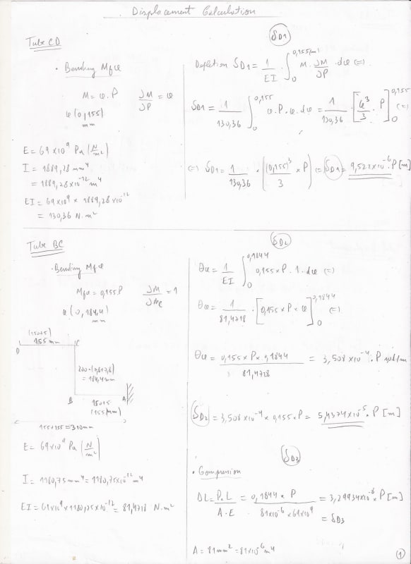

Hello again.

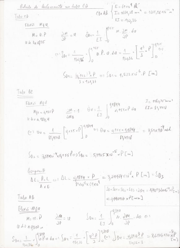

I am calculating the displacement using the Castiglian theorem as in the annex, but I am obtaining analytically for example for P=5N, a displacement of SD=0.7 mm on D position.
(0.140136x5=0.7 mm)
When experimentally, on the comparator, It obtained a value of displacement of 1.4 mm for 5 N. Can anyone help or explain the cause?
it is hard for me to follow your calculation, I appreciation you were just scribbling it out. Take the time to organise it, maybe use two pages ?
where do you calculate your result ? ie so with P = 5, the deflection at A is d = ...
you seem to mix units ... meters and mm. Maybe you've adjusted the index properly, maybe not ... it is often a source of error.
The horizontal segments are dominated by bending, not so sure the vertical is ??
what about displacements due to shear ?
My guess is that you have not properly accounted for the change in slope at point C.
I would not use Castigliano's method to calculate deflection at D. Point D deflects both vertically and horizontally. Its vertical deflection is equal to the normal cantilever deflection of the round pipe plus the concentrated slope change between B and C times length CD. These can be calculated directly.
The horizontal deflection of point D is the slope at B times height BC plus the horizontal deflection of BC.

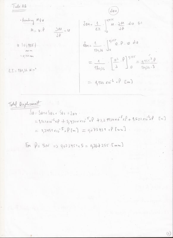

On the AB tube:
I was using x (0 to 310 mm) on first post. But i think its (0 to 150 mm ) on AB tube. it is right?
Now for a P=5 N i have 0,367255 mm witch is very low compared to the experimental one by the comparator 1,4 mm.
Before we waste too much time on this, let's get some agreement on the basic material properties. For the round pipe, I can't quite make out your illegible handwriting for the value of I but what material has a value of E = 69*10[sup]4[/sup]Pa?
Tube BC is 20x10mm with wall thickness of 1.5mm.
I[sub]minor[/sub] = (20*10[sup]3[/sup])/12 - (17*7[sup]3[/sup])/12 = 1,181mm[sup]4[/sup]
EI[sub]minor[/sub] = 200,000*1,181 = 236e6Nmm[sup]2[/sup] = 236Nm[sup]2[/sup] (for steel)
Are we agreed on the member properties?
