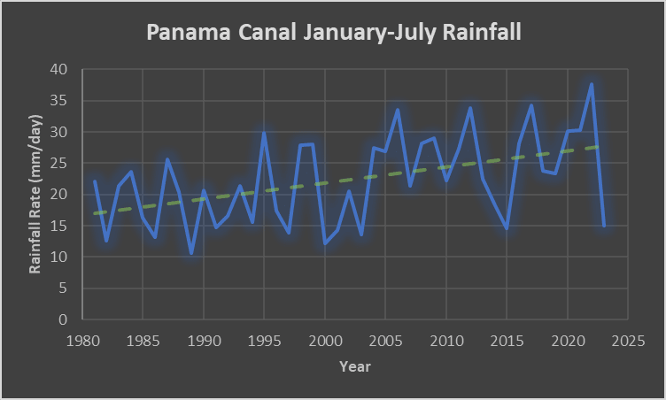

So the yahoo article ignores the doubling of the canal capacity in 2016. Silly hitpiece. There are two issues, short term January-July (it rains in the latter half of the calendar year)
and the pressure on the long term storage. The population has doubled in the last 35 years, have they doubled the water storage?

Looking at Greg's chart, I kind of think it's a combination of climate (change or severe El Niño).
The chart seems to show the high and low rainfall rates diverging, which would also tend make higher peaks and lower troughs in the amount of accumulated rainfall.
Yearly rainfall for Panama is here.
Low was 225cm, high 285cm Only 25% variation over the historic record. The variation around the average of all is only about +/-10% and I don't see any real profound trend in the yearly amounts in recent years. Looks like that's pretty much holding at typical levels. Panama's problem has always been extreme variations between wet and dry seasons. The Chagres River has one of the highest seasonal flow rate changes in the world. At one time i think it was some 300 m3/s to 3000 m3/s. (I'll try to confirm that.) I think that both the rainfall intensities are higher and the dry periods are even drier than before. It's hard to tell if the water saving features of the expanded canal are adequate enough to compensate for the more extreme dry periods. The increased system outages would lead to a negative conclusion there, but I suppose without hard data on how much water is being saved and the probable increased draw for use by local populations, its difficult to get any further than that.

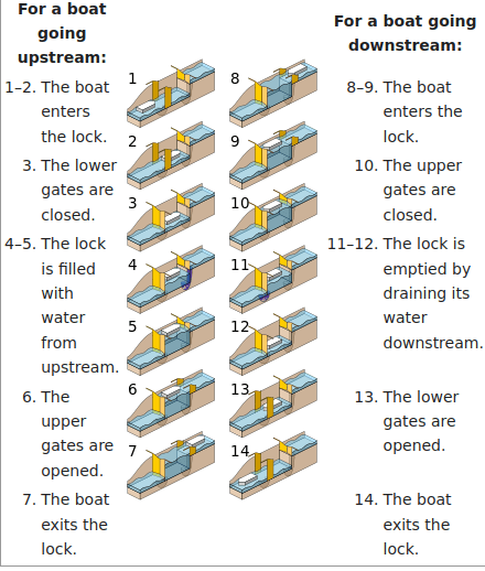

The Panama canal is driven on gravity fall of water, so the power requirements to operate are minimized, which makes it very attractive. No pumping solution seems likely to be usable for the change in height required. Competition by overland systems has to overcome that advantage. There is that pesky range of mountains along much of the west coast of the Americas that leaves the Panama canal in a superior position.
Transferring cargo onto barges that fill the locks more completely might be a better solution than transferring cargo to trains. More hull in the lock means less water to fill it.
The volume of water consumed lifting the navigable volume is constant regardless of what is floating in the navigable volume.
The volume of water consumed is a direct function of the number of cycles (IE Traffic).
Attempting to recover water runs the risk of pumping seawater into the pond.

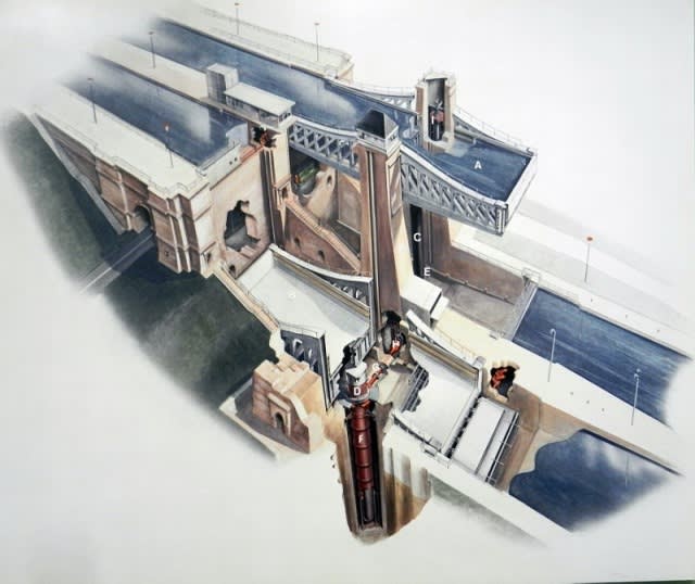

A Lift Lock would not consume the lifting volume, but it still takes energy to lift the volume. Some energy can be recovered by balancing 2 lifts against each other. Might be useful for small vessels up to say 3000 tons displacement.
Peterborough Lift Lock #21
They could recycle the water, 200000 tonnes at 26m, that's about 14 MWh per ship, which takes 11 hours, so call it a 1MW power cost per ship while it is in the canal. 50 ships a day. 25 MW That's a tiny power station.
It's no good blathering on about climate change, the rainfall hasn't changed significantly in 100 years.
