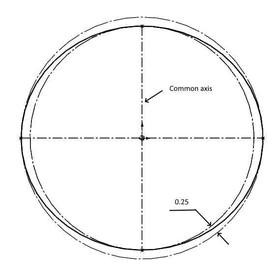

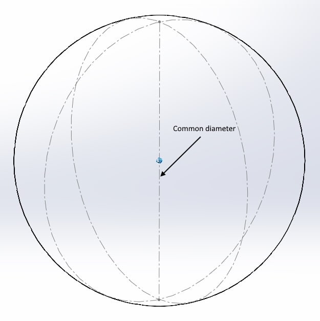

Divide the ball into four quarters, like an orange. This will form a common axis (diameter) for each circular element mentioned above. This diameter can be 25.4 max to 24.6 min, but it is going to be the same for all circular elements. Now each circular element will have three things in common with the rest of them: one actual diameter (D) and two tolerance zones. Each tolerance zone diameter is going to be D + .125 and D - 0.125. All the points of each circular element have to fall between these two tolerance zones and not violate max and min diameter constraint(for example a circular element can't be the outline of the bigger tolerance zone in the illustration below)
This is where I am having trouble seeing your viewpoint. Why must they all be the same size?

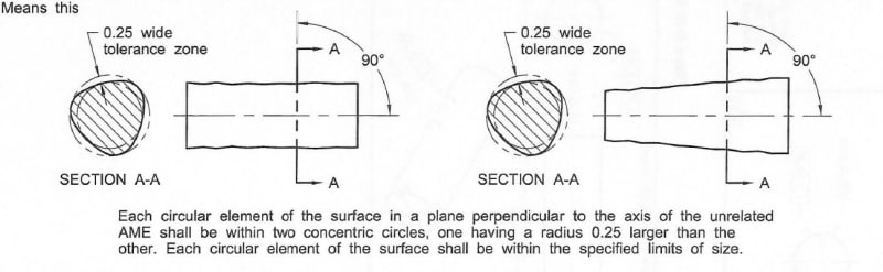

Perhaps we could back up to a simpler example of circularity of a regular cylindrical part (Fig. 8-10 of the 2018 standard). You seem to be saying that each cross-section where I measure circularity must have the same size/diameter. But that is not true, even if their center points all connect perfectly.
So when we transition to a sphere, why is it reguired that every slice where I measure circularity have the same size/diameter?

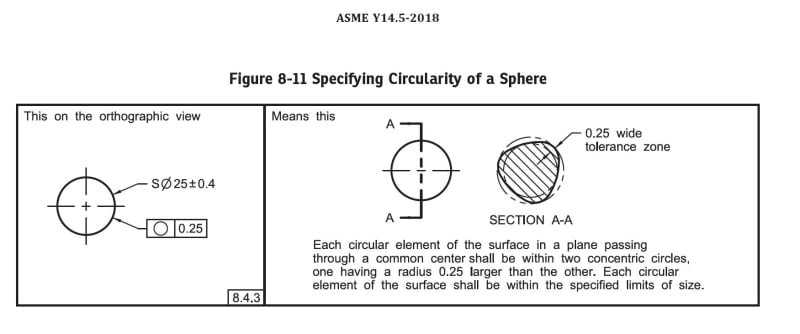

Why do you make this an issue? Circularity feature control frame controls "Sphericity" when it is applied to a spherical feature (dimension with "S" as prefix).

To your point: the size dimension is preceded by S, but the geo tolerance is not preceded by an S. That's the difference, and that's why I'm thinking that the many circular sweeps around the sphere don't have to all conform to the same size.
This is because spherical tolerance zone of a spherical surface is wall thickness of a hollow sphere.

Not at all. The example from the standard is quite clear - each circular element of a cylindrical part can be any diameter within the specified limits

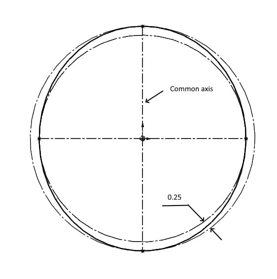

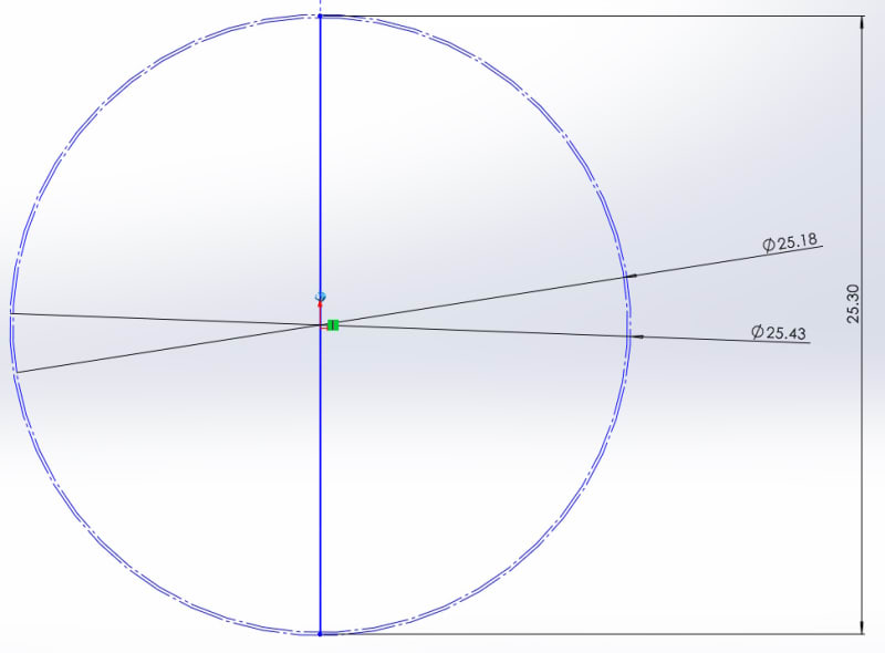

The difference is that those are "lengthwise slices" and have no common points. When you slice a ball along the same axis you are going to have two common points for each cross section. In other words each cross section is going to have at least one diameter in that cross section that is common for all of them. However, that's where I was wrong. There are two extreme cases here. You can build the tolerance zones here in two ways - one cross section can have the internal circle of the tolerance zone touching the common diameter and another cross section can have the external circle of the tolerance zone touching the common diameter.
So, it appears the actual ball surface profile tolerance is going to be 0.5, which is twice that of the circularity stated on the drawing.
You just need to interpret it per its definition in the standard. It is rather simple mathematically.
You have two spherical surfaces that are concentric. You expand the smaller one until it touches the spherical. You also contract the large one until it touches the spherical surface. The thickness or normal distance between the two spherical surfaces is roundness or sphericity.
